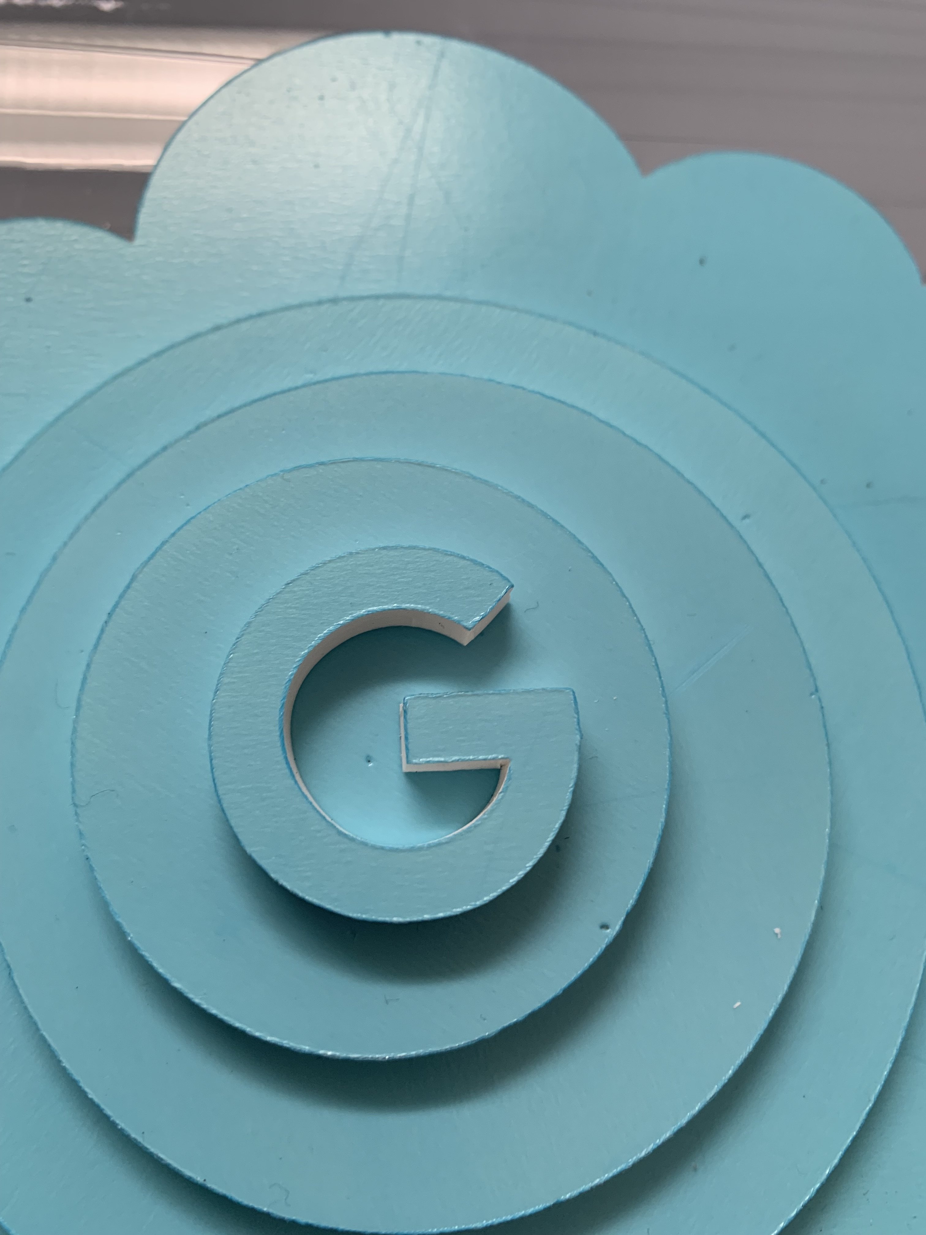

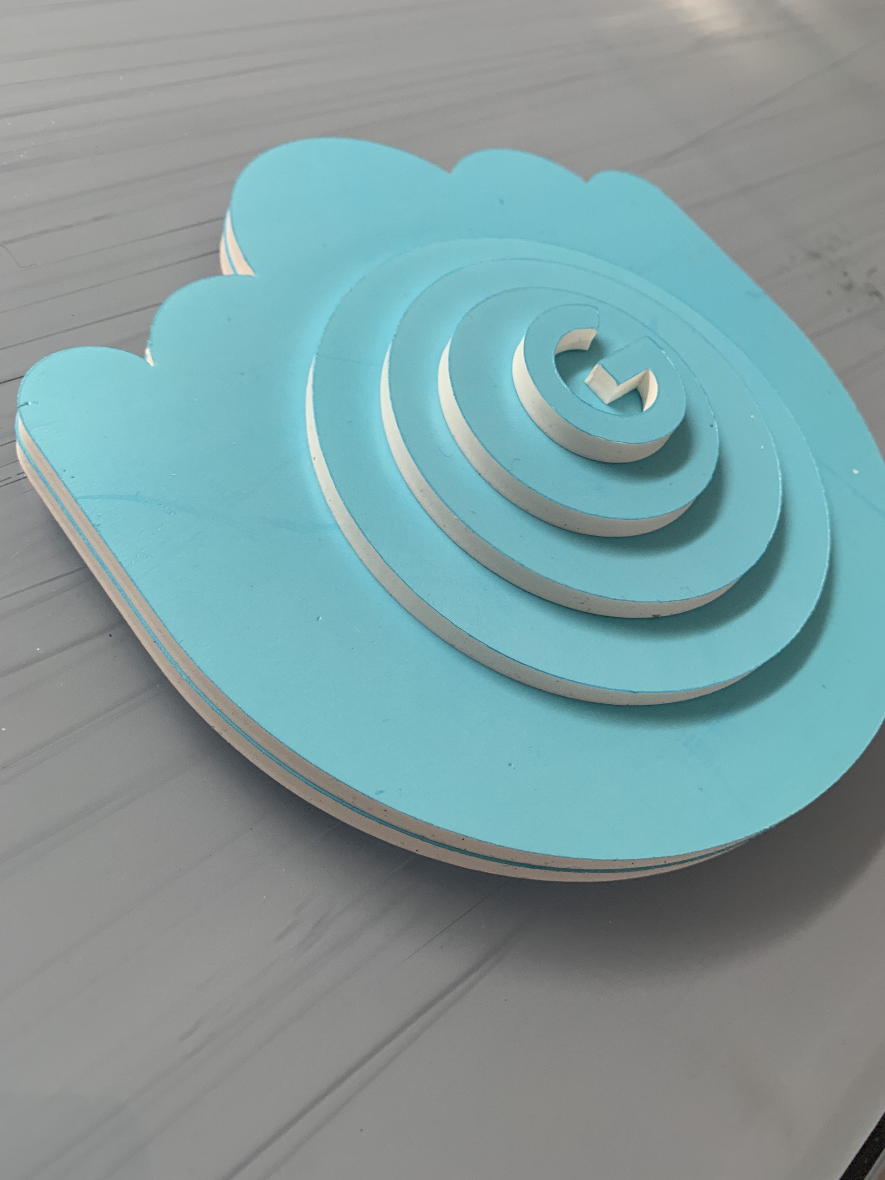

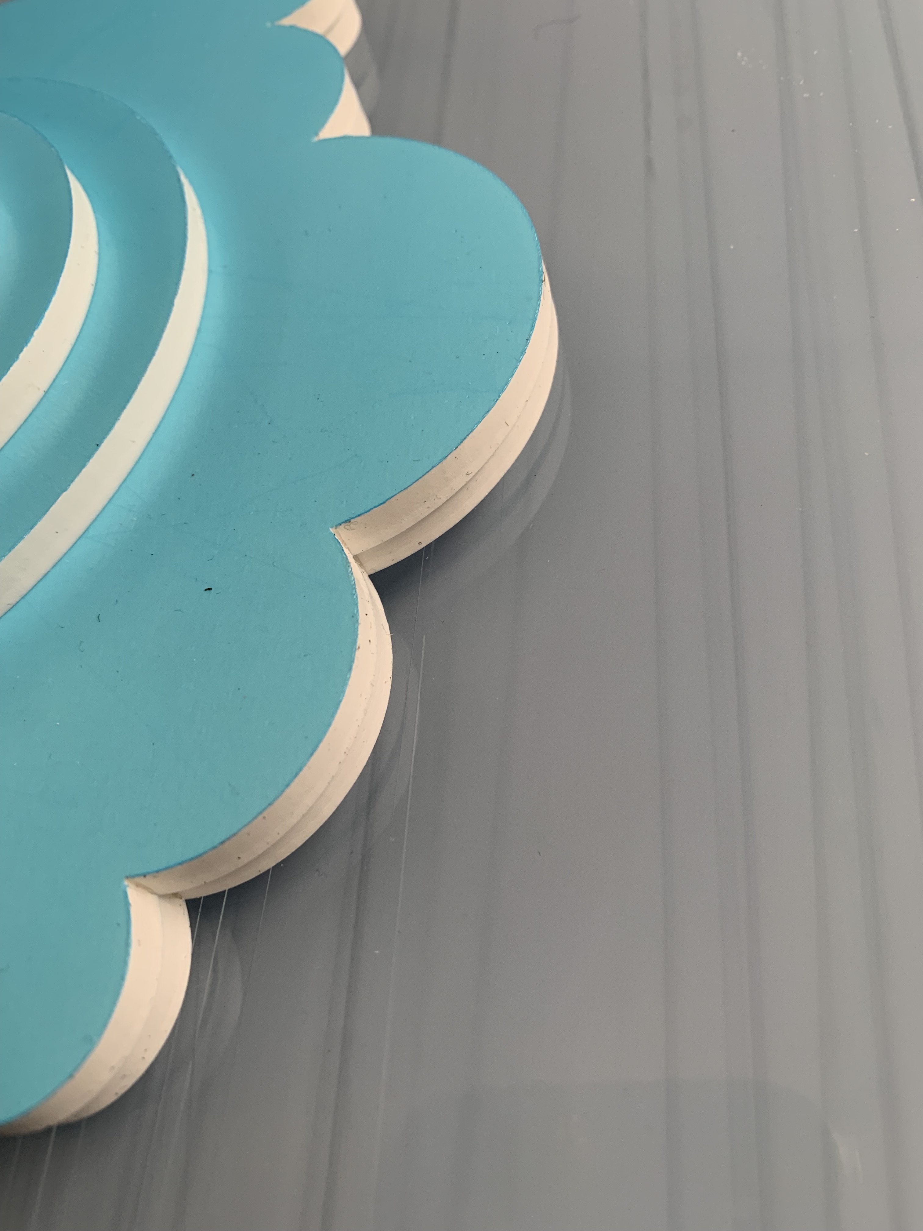

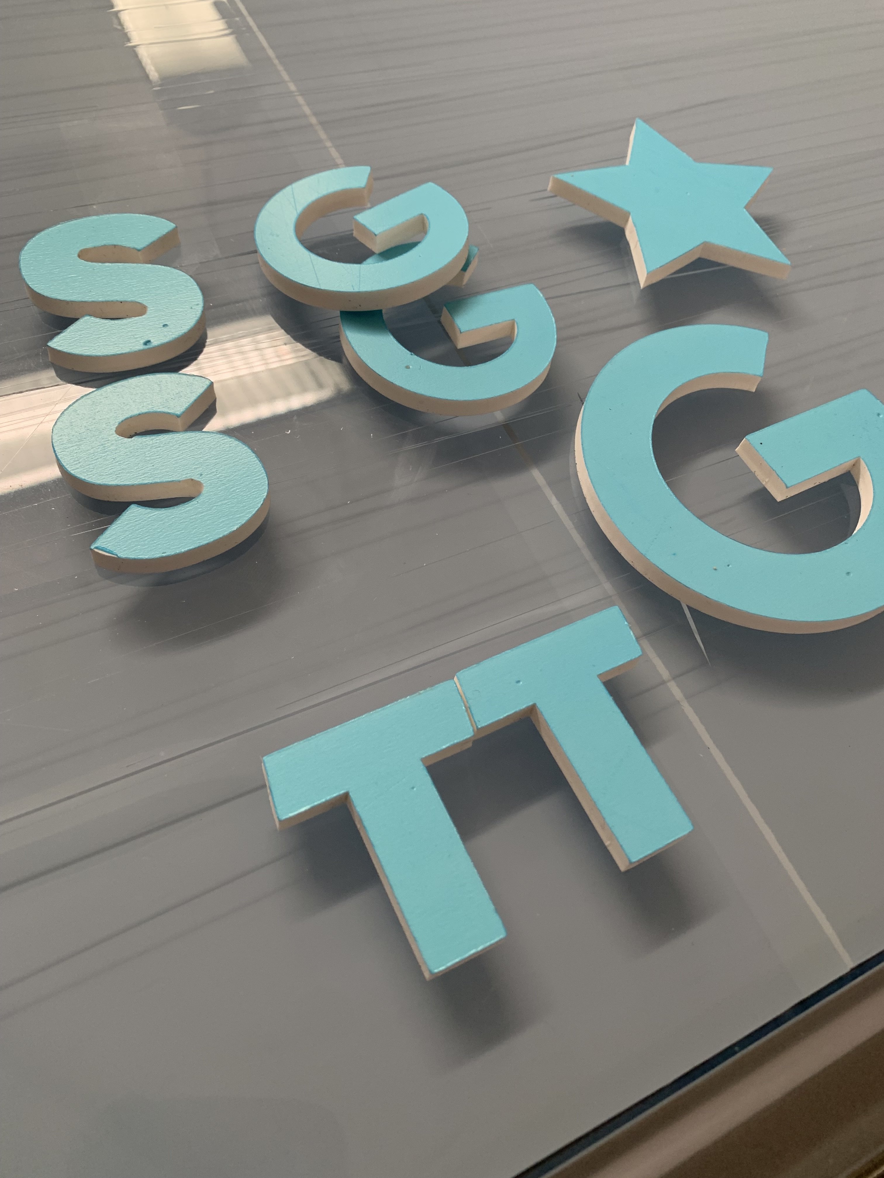

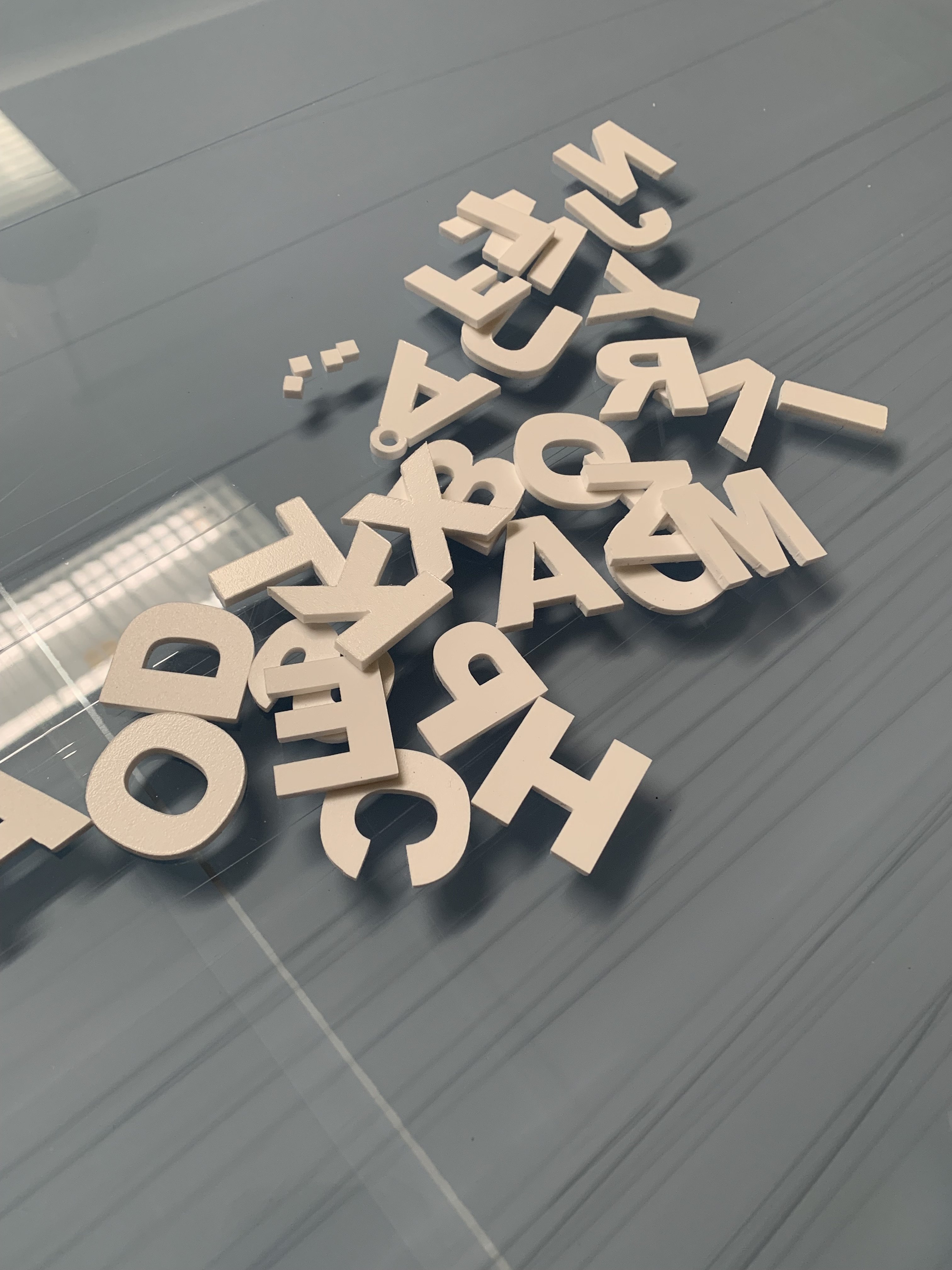

Multi pass 1.5mm and 400mm/s. I think I use 0.4 in compensation
And yes the knife tip is intact
Better results if not cut letters with round corners.
