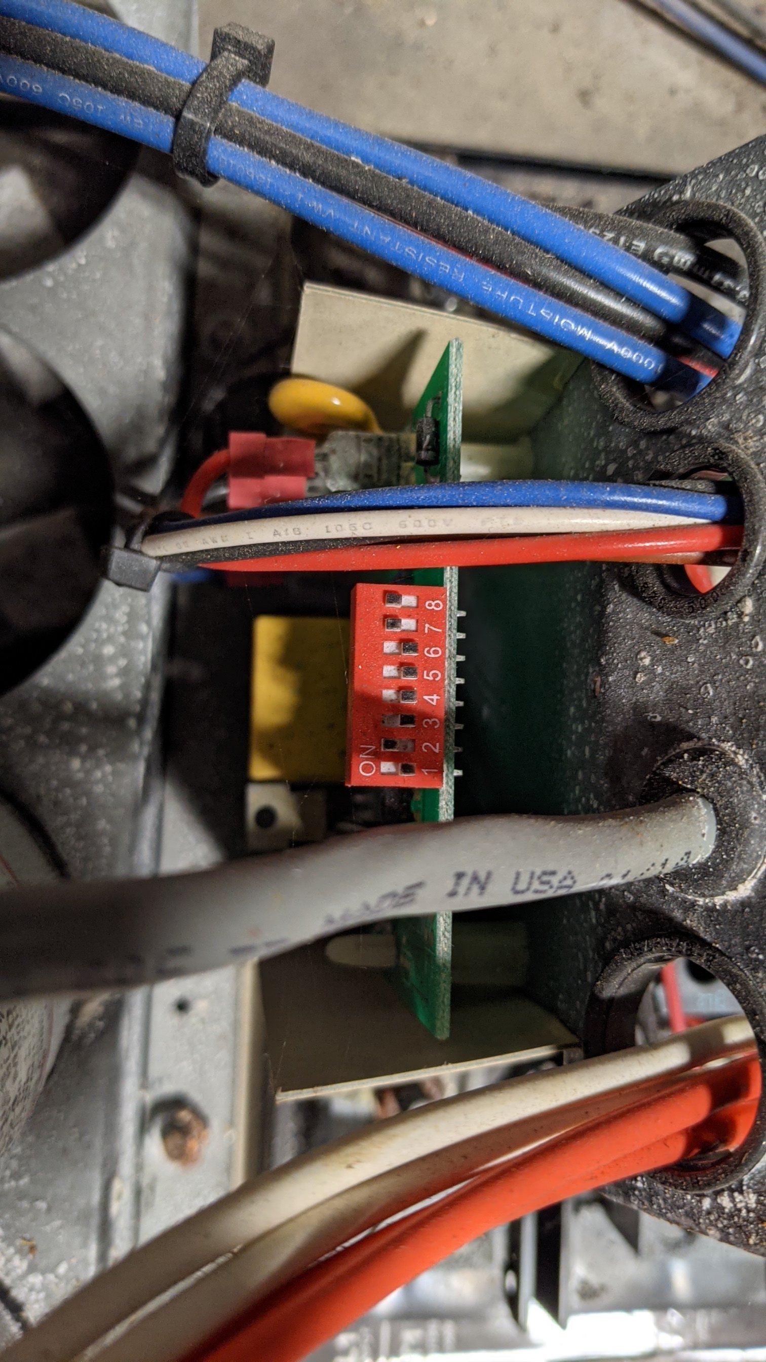

It has dip switches inside the panel which adjust the capacitors. The easiest thing to do is call American rotary and they will walk you through adjustments until the power is balanced properly. Then he would obviously need to get the machine running and check them again. Here's where you adjust it, this panel burnt up last year, it's an adx20 but pretty much the same thing

Here is a photo of the jumpers on the machine. I also forgot to mention this machine was hooked up as 208+N from the original owner.

Okay. So, we moved the top jumper on the photo above. Everything has powered on and it’s working. It’s now showing up in Axis control but I am getting a emergency button error.

Does anyone know if these jumpers are correct? This is the area where we moved the top jumper and are now getting an EMERGENCY BUTTON PRESSED” on axis control
