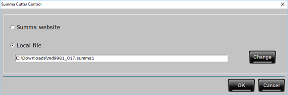

    In case you opted to use a local file, navigate to the folder where you downloaded the latest firmware and select the new firmware:
    [​IMG]
    This will start the upgrade procedure.

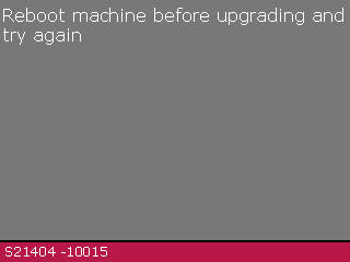

    In case a job was still in the buffer of the cutter, then the upgrade may fail. An error message will then be displayed:
    [​IMG]
    In this case, you will need to restart the cutter and start over again.

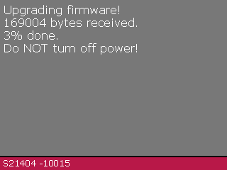

    You can follow the progress on the display of the cutter:
    [​IMG]
    When the next message (Upgrade done successfully) is displayed, you need to power down and then power up the cutter to complete the upgrade.

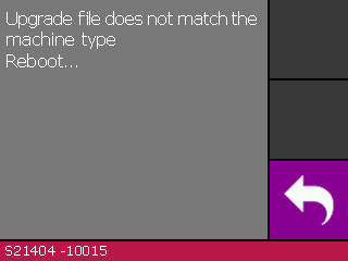

    In case an incorrect firmware file was sent to the cutter, then an error message is displayed:
    [​IMG]
    In above cases, you will need to restart the cutter and start over again.
