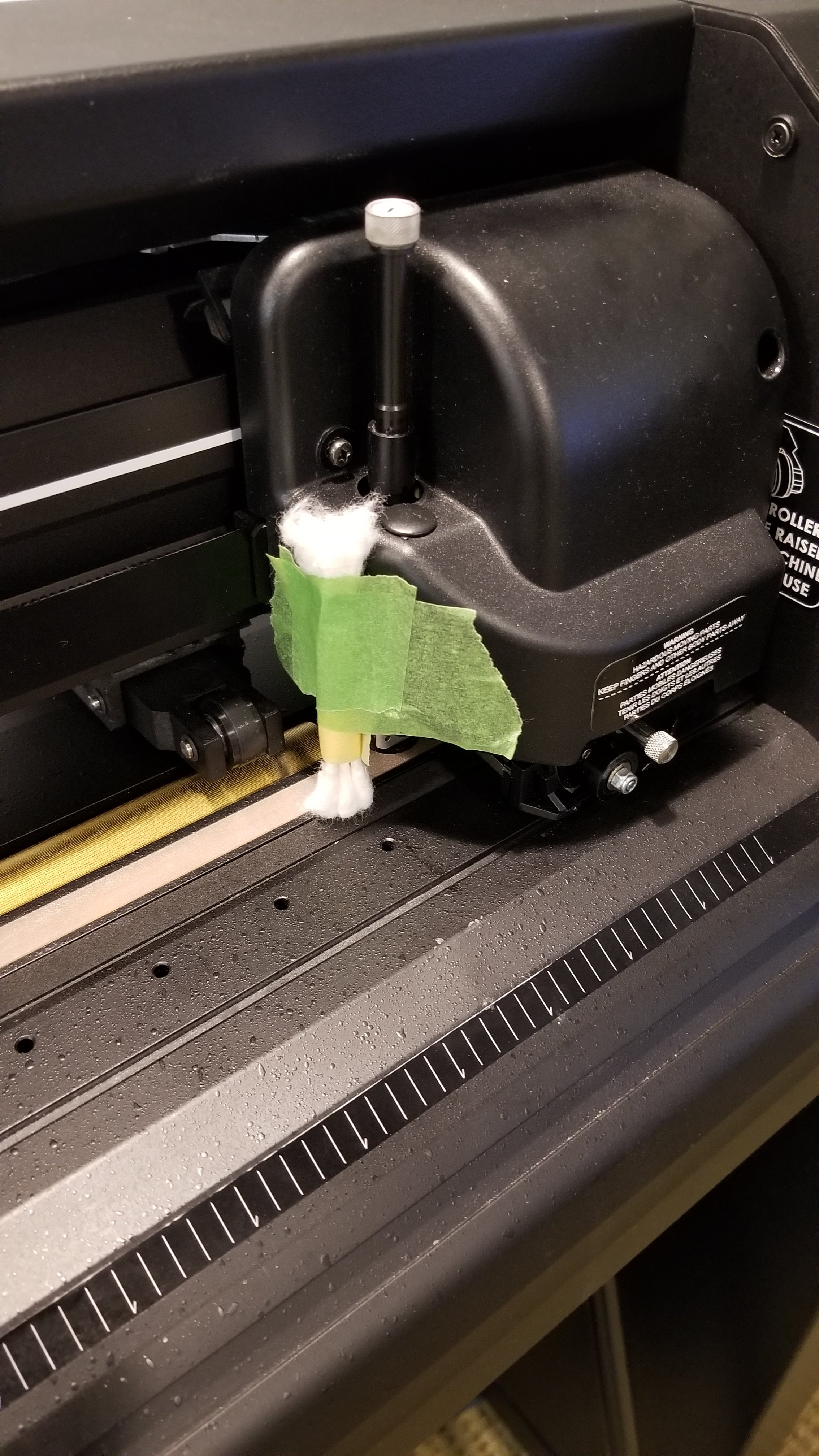

    Yep, i do it all the time. Only issue is that when i first got the summa, the blade kept dragging across the media and scratching it. I was told to build an in feed and out feed table to keep the material from buckling up under the head. My workaround is to take cleaning swab to the side of the cut head to keep the media pushed down around the blade and haven't had an issue sense. I would have thought that for a 10k machine they would have some type of attachment but the cleaning swab works just fine for me

  7. TDFcustomSL
    TDFcustomSL Member
    356
    28
    28
    Feb 13, 2012
    Kansas
    This is what I am using as I type this, I am out of cleaning swabs so these are just Q Tips. May not be pretty but it works. I wish I knew someone that had a 3d printer and the same cutter...I have an idea for making a new head cover but executing the idea is beyond my level of smartness.
