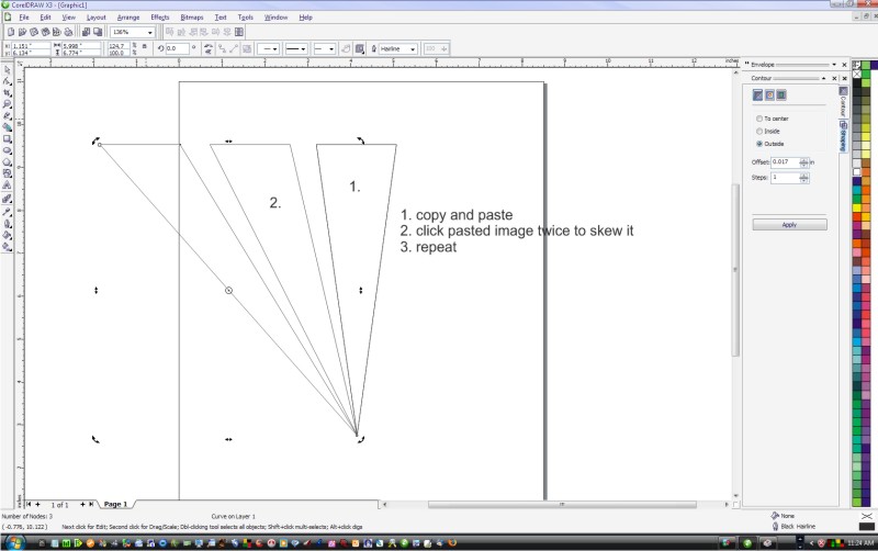

    as requested.

    look of the finished product? I must be missing something.

    If using FLexi Draw your square or what ever shape. Click drop down Effects>Stripe and then choose Radiant. You can then set a number of attributes in Desogn Central. No Copy and pasting and all elements of the sunburst are mathematically correct.
    Just my 2 pennies, see Flexi get bashed quite a bit here.
