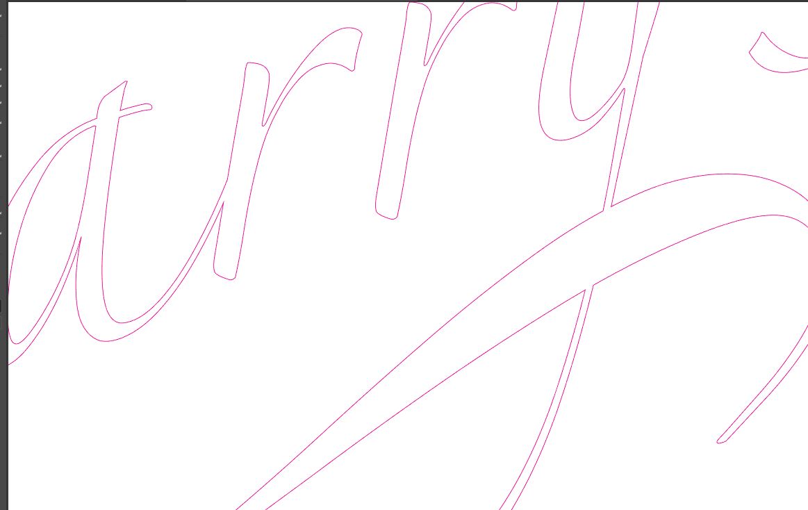

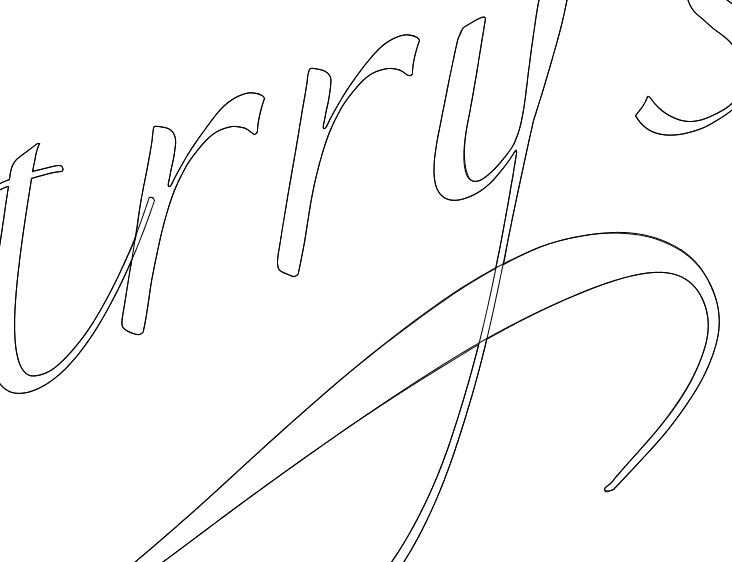

I am having issues with Onyx opening files from AI incorrectly.
I have attached pics of my .ai file and then the way Onyx Cut Server opens it.
What am I doing wrong?
It looks as if it isn't welded in Onyx, but it is in AI.

That's pretty typical of Adobe files no matter what RIP does it. Did you already convert to curves (outlines)? You may need to weld them together in Illustrator.
shoresigns
AI files aren't meant to be used as production files, even if some RIPs support them. You should be using PDF or EPS, and that might solve your problem.
Occasionally AI files will produce unexpected results in non-Adobe apps, because an AI file typically has two copies of the artwork in it, one coded for Illustrator, and a PDF copy for linking with other Adobe apps. Neither of those two formats inside your AI file are meant to be used outside of the Adobe universe.
