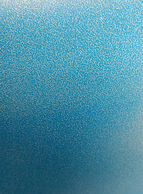

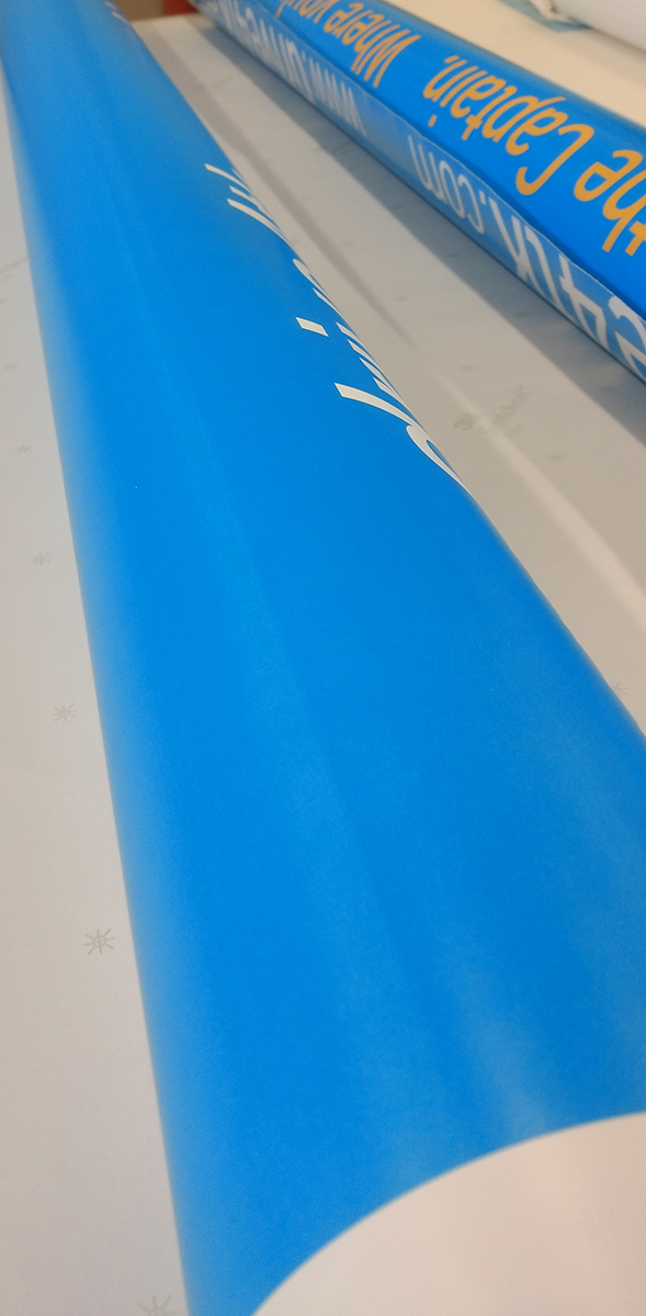

    I just recently had to switch from IJ35 to IJ35C (Comply Adhesive) for a large job needing a 60" roll, since apparently the supplier is switching over that way. Now I'm having an issue on my HP Latex 360 when running a long take-up job of these weird streaks of various sizes from inches to half way across showing up from the carriage side. Printheads are all new and calibrated, no other material shows this effect and if I switch it over to my Epson S40600, there's no signs of this at all. And looking at the print profiles between IJ35 and IJ35C, they're practically identical.
    Anyone else encounter this before?

    I've been having the same issue with the IJ35C. Used to work great on my VersaCAMM, but a couple months ago started a wavy streak. Tested the material on my supplier's printer (TrueVIS) and got the same effect. Used the exact media profile downloaded from 3M. Returned both rolls to 3M. Bought another roll from a different supplier, same problem. Have switched to Arlon 4500 MLX and have no further issues.

    This is exactly what mine is doing. I bought it from Grimco a while back and hadn't used it until recently. what a nightmare trying to find a profile to print on it and nothing is working. I may be out on this because I purchased it a while back.

    I got word straight from Grimco that it is the plasticizer on it. Apparently, the next newer printer model has a foam wiper for this stuff, otherwise it screws around with the Latex ink, but not the solvent.

    It can mess with solvent printers too, but not as quickly. They should swap out that roll for a newer one. This is a problem with the vinyl, not the printer. The newer printers have the roller, but even that won't overcome severe plasticizer migration. They've just had that roll sitting around too long.
