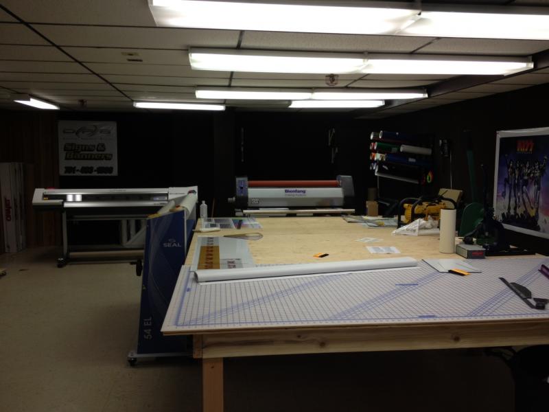

OK I finished my table a couple weeks ago it is 12'x8' so three sheets of smooth plywood top. I laid down a 4'x8' grid marked cutting mat on one end. In the past I have used thrifty White 1/8" Masonite with white surface. only problem is with time it wears and scratches I may still use that on the other 2 sheets just wondering what are others using?

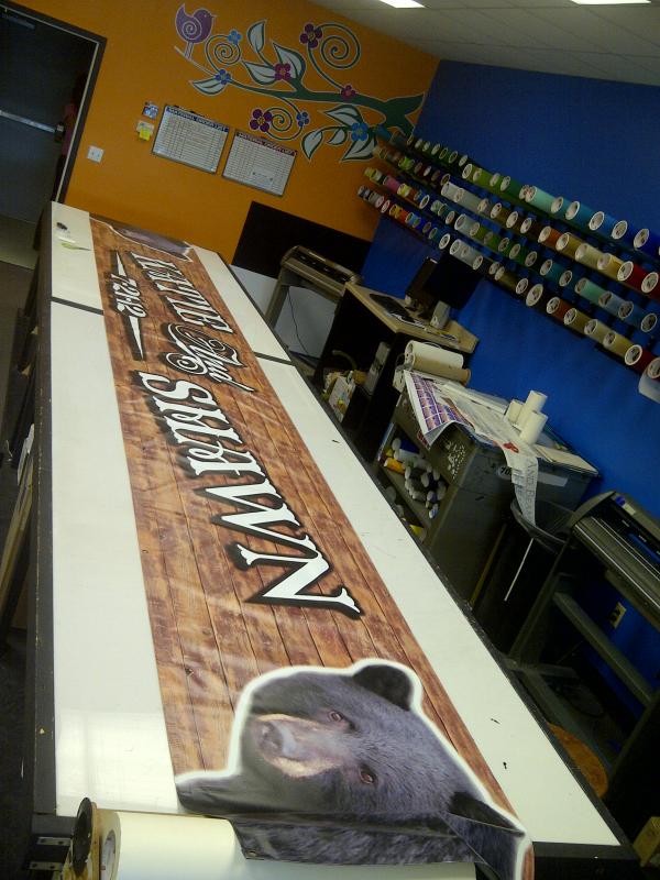

We use White 1/8" acrylic over MDF. You can flip it when it gets to scratched from cutting, its fairly soft so it does not tear up blades to bad. We have had one piece on a table for 2 years now and have yet to flip so it lasts a pretty good while and it's fairly cheap. I also like the fact that it has a bit of static to help "hold" down vinyl sheets that don't move when it's being masked.
I've attached a picture of the smaller 18' X 4' table. In the next few weeks I'll be building a 5' X 20' table with more storage using the same materials.
