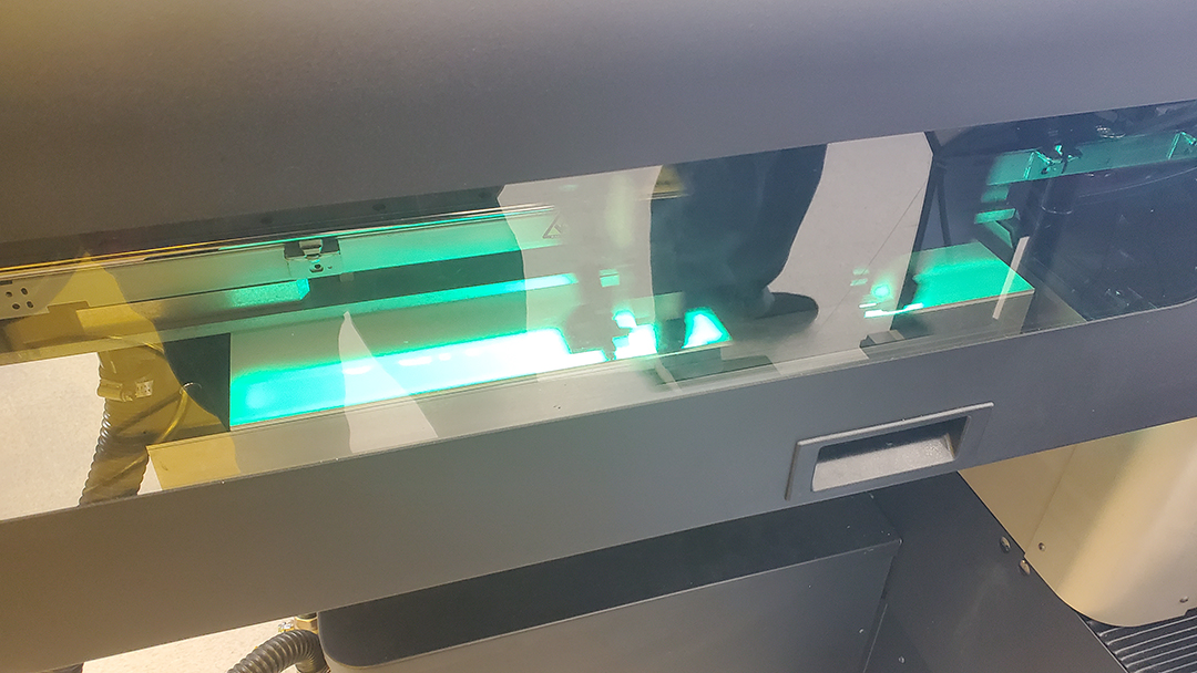

The braille kept getting 'dirty' with ink specks and stuff in it. Luckily we could pop most of the bad ones off and move on. Had to turn the UV lamps way down to minimize the problem. Then ran a light only pass to harden the partial cure from the first pass.
Customer must have liked them, we just got another order for more ssssooooooo....learning experience I guess.
