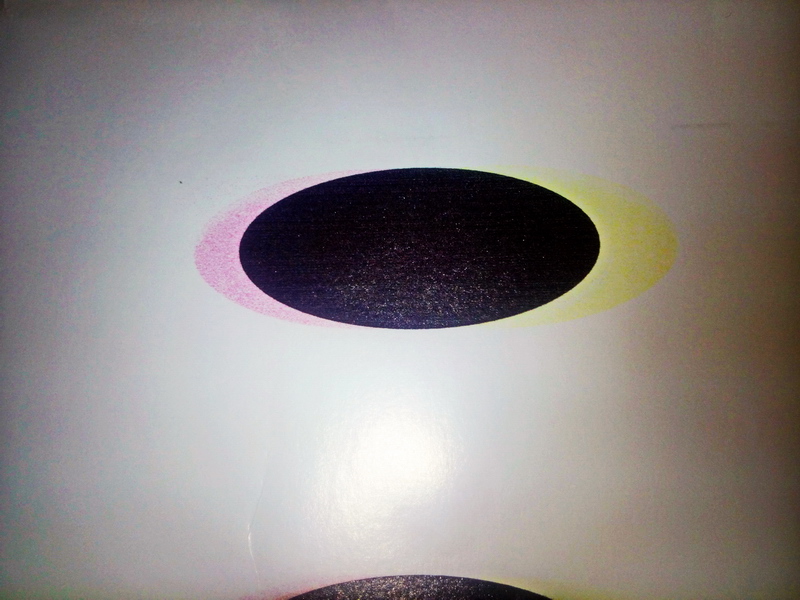

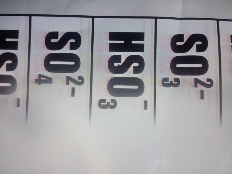

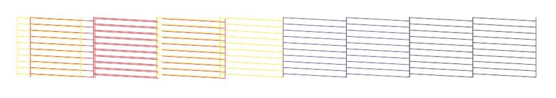

Hello, good people! (Translate.google use.) Test nozzles had to draw - photo did not happen.
Where to dig? Can anyone come across?

That has to be a dirty encoder strip or cable issue as the heads cannot go out of line as the head is a complete unit with all four colours built in.
SC
I don' t think the encoder is the issue. I don't think it would fire some correct and some incorrect. The strip doesn't tell the printer where each head is at. I believe it tells the printer where the carriage is and then off of that the heads fire. This would seem to me to be a head or printhead alignment issue.
heyskull
I was also thinking maybe not the encoder.
First I would change the head cables with OEM (which is the cheaper fix).
They do get contaminated with ink spray.
Then the head (which is the expensive fix) !
But change the cables also.
I hope it's a cable as that print test is perfect.
SC
Phenx

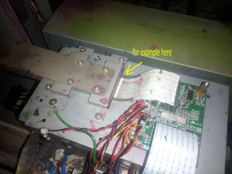

Thank you, everyone! Problem solved ... The only thing I did - it freed сable coming from the motherboard to the carriage and deposed him in those places where it is attached to the casing. I do not know if it helped or another, what a miracle, but I did it thanks to your mention of any potential problems with the сables!
