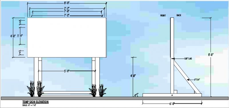

He just wanted a large one-sided 4'x8' sign on skids and the top 8" above the ground, so it could be seen over a berm between it and the road.
I was thinking of making it out of treated 4"x4" posts 8' long with kind of a skid base to keep if from blowing over. I'm not real sure what I could use for the main 4x8 white area, 1/2" thick sign board, does it come already painted white?

J Hill Designs
like so - and I usually anchor the skids w/pounded in stakes or I guess sandbags...

J Hill Designs
I would just use signply...you could use coro, but the structure would have to be more robust, as usually the signply board helps to stabilize it...

jhilldesigns,
Thanks for the info, can I ask you another question, based on the drawing and the use of signply, with applied 651 vinyl (see text below), what would your ball park price be, delivered to the site?
