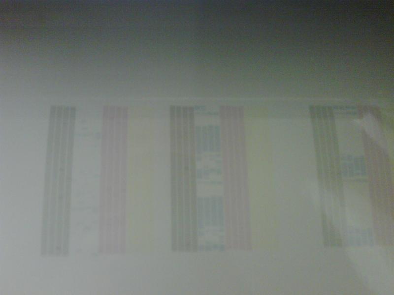

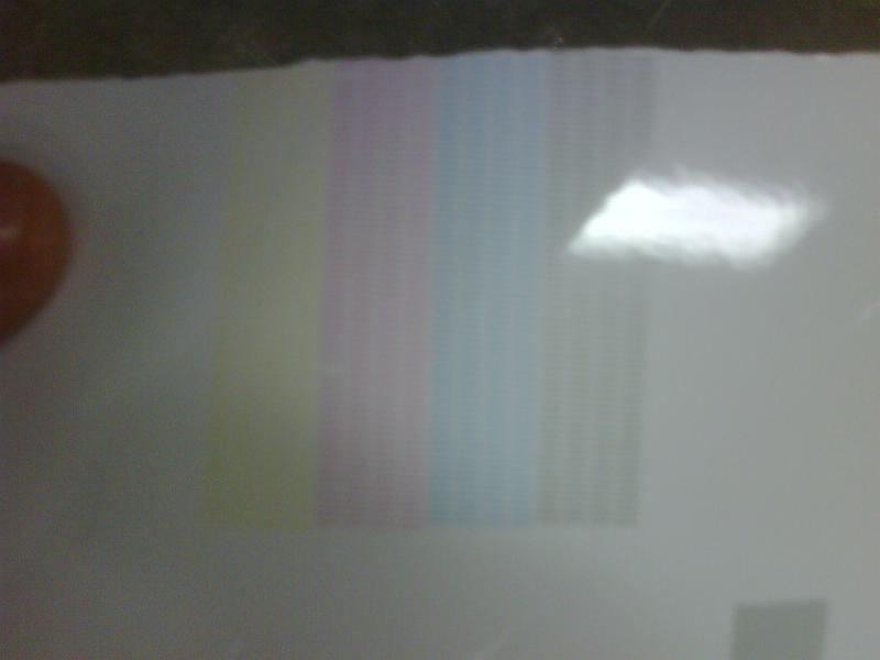

    Print Tests
    i have attached some pictures to better explain.
    good test.jpg was done tonight. pressed print and job finished but colours off.
    did a other print test and changed ink and got bad test.jpg..
    skye
