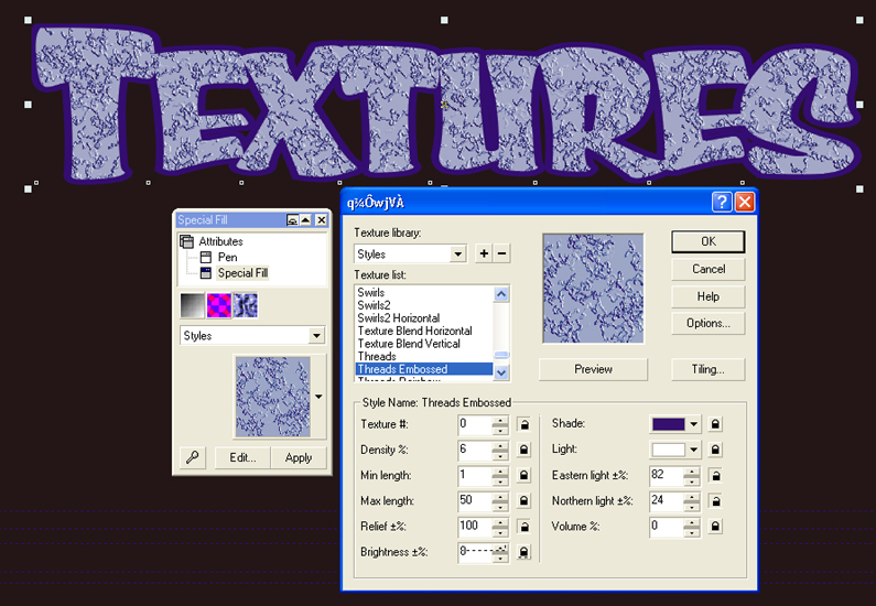

  5. Steve C.
    Steve C. Very Active Member
    3,278
    3
    May 22, 2003
    There are lots of ways to change the look of texture files in corel. Use the special fills editor to change the size, color, resolution, tile size and dimentions, pixel rate and positioning, texture, relief, light. light direction, etc,etc.

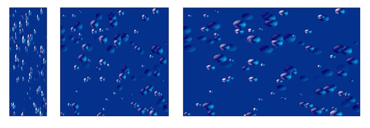

  6. Colin
    Colin Major Contributor
    4,540
    15
    38
    Sep 16, 2004
    Earth
    Yes, but unfortunately I can't see which command changes the problem I'm speaking about.
    Here's an example: draw 3 rectangles; one tallish, one square, and one longish. Select them (one at a time or all at once) and apply a texture fill. Then see what I mean......only the evenly square one looks correct.
    3,278
    3
    May 22, 2003
    I use Corel 8, but the setting should still work the same. In the Texture Fill window, Click the "Tiling..." button. In the Tiling window, uncheck the box at the bottom for "Transform fill with object". See if that works. It does for me.
    BTW If you use Corel, Try working with that Edoras font there, then export or copy to Inspire with fonts converted to curve. I'll bet it will work for you.
