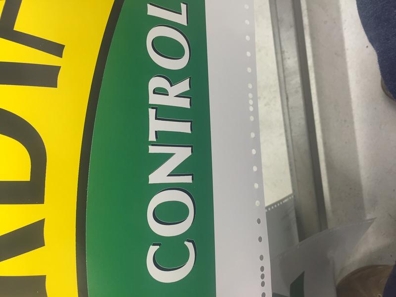

Im Having an issue with mine maybe you guys could help.
Hey im having trouble with my edge and i saw this and figured id ask. Seems you have a lot more experiance with the edge then i do.. I have the Edge 1 and after it being in our shop for 20 years finally something is wrong lol. It seems to have lost its registration when doing multiple colors. The particular job im doing is 3 color yellow green and blue. The thing i dont understand is it only misaligns one set of colors the blue touches both the yellow and green, but when the blue butts up to the green there is a gap of no color even tho in the file it shows them touching. Any ideas on something i could do to fix that? I have a job due this week and cant figure it out.... Thanks!!!
signsourcellc
heres what its doing
it might be hard to see but that white outline between the blue and green shouldnt be there and my customer isnt happy

signsourcellc
How would i do that? I just tried selecting the blue and going to trapline and it says The current fill must not be a clear fill. But im selecting the blue and it shows that it has navy fill? Also i am using omega if that changes anything
signsourcellc
You guys are awesome.... I was trying everything all day on Friday I dont think i would have been able to get it with out your help. THANK YOU GUYS for saving the day...
