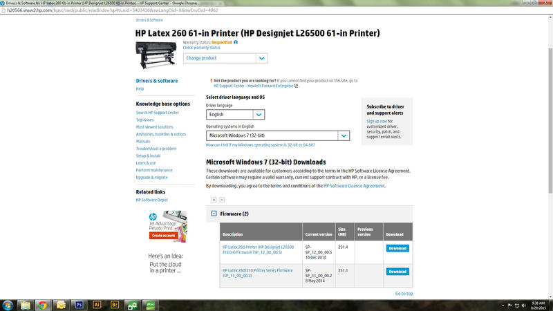

eahicks

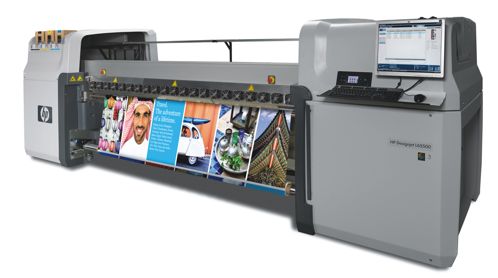

Andy D
I have used a HP Designjet L65500 Latex printer( I think that was the model) and I hated it.
Very hard to load materials & every time you changed materials it would take 10-15 to self check & mornings were worse, it would take almost a hour from the time you turned it on in the morning
for it to go though all it's self checks and heat up and you could start printing.
It had light vertical streaks on many materials.. and there were other issues that I can't recall.
attachment.php
The HP L65500 was the first Latex model on the market, in the years 2009-2010. They learned a great deal from the initial users experiences and have made dramatic improvements across a whole range of fronts. The current model uses HP Latex 3rd-generation inks, and the vast majority of customers and users are more than satisfied with these printers (Latex 3000 / 3100 / 3500).

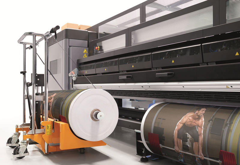

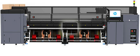

player
The HP 3500 looks massive:
attachment.php
attachment.php

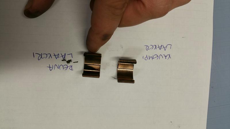

Split76
The bearings and felts were 4 months old (tech changed). Before that, those were last changed 6 months before that. I've been cleaning and lubricating both carriage rails 2 times in month for the last year. So i'm not missing or skipping anything. Last week when i did that procedure, the message came straight again after cleanin and lubricating. After that, i took the power off, took the printhead cleaning kit out and slided the printing unit to the center of the rails, took the lower felts off, cleaned both rails really good and slided the printing unit both directions and cleaned and slided and cleaned again.. then i oiled the rails, did more sliding and after that , assembled the felts, slided and oiled once more :D
That helped for atleast those 2 rolls.
I changed the bushings today myself. Right one looks quite funny, last time both bushings looked like that (4 months ago) . I think the carriage is somehow damaged and the bushings are not where they should. These bushings lasted 1500m2 (22 full rolls). Bushings cannot be inserted wrongly or at wrong place so maybe the only solution is to change the carriage.
I guess i'm laughing my *** off when I get the price for new one :D
