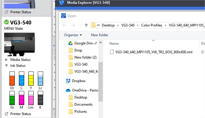

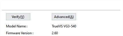

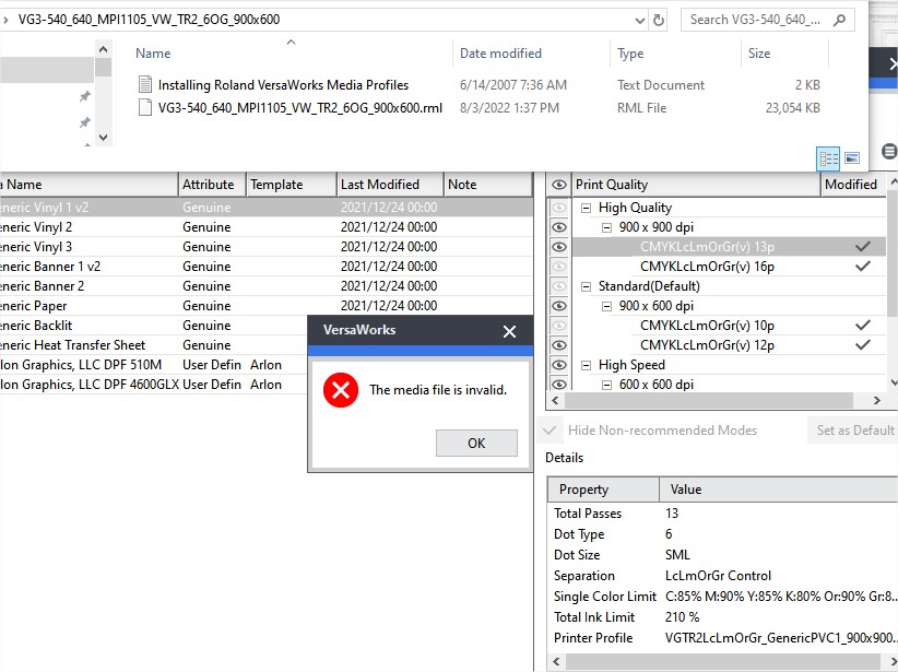

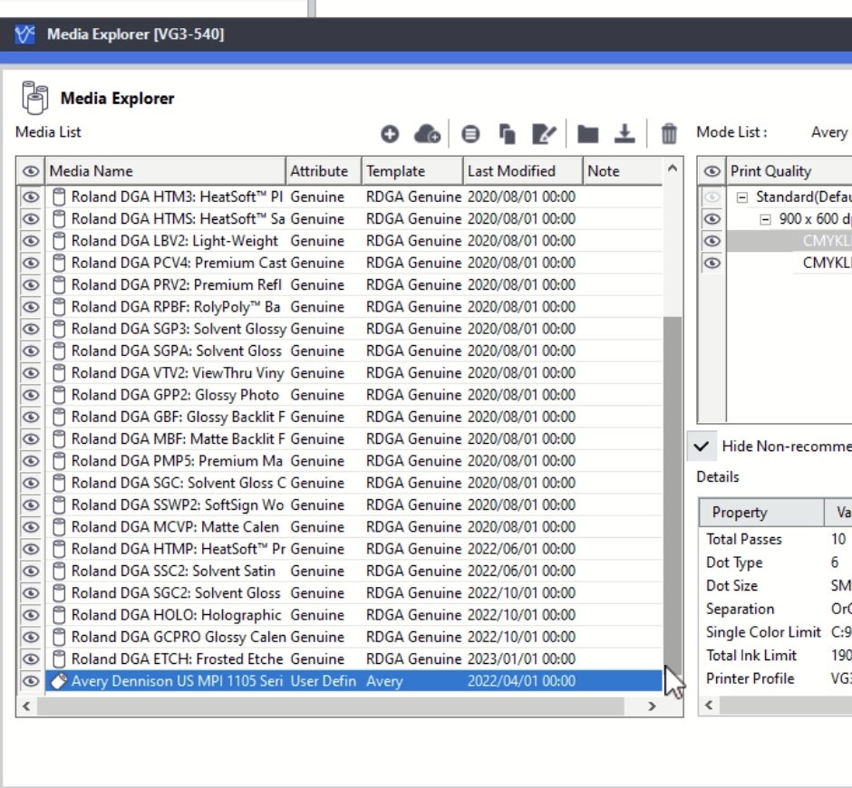

Has anyone else run into this? I downloaded it directly from Roland. All the specs are right for what I am running.
When I try to import the file it says "The media file is invalid".
The same error if I use "Add media from the internet" directly in VersaWorks.
Edit: tried the profile from Avery's site and same deal. Not 1 Avery profile works for me. Arlon & 3M load just fine.

JamminSigns
Well that's not right.
Aprreciate the suggestion, same result when run as Admin.

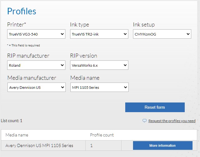

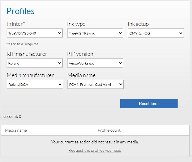

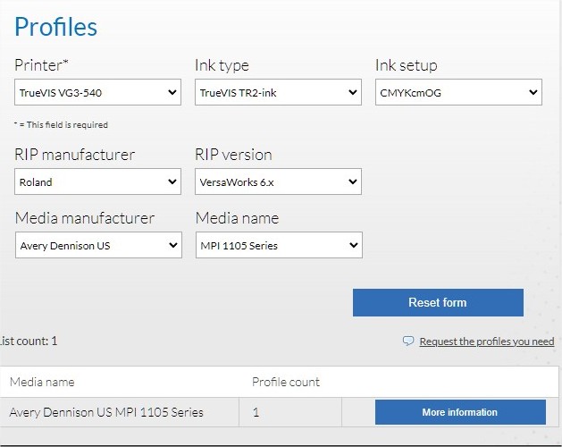

JamminSigns
Yup had Tr2 checked.
CMYKcmOG - as ink profile
Left everything same shown and switched to Arlon those install np, switch back to Avery not a one.
Dang, this is our go to material for so much stuff really like to use their profile.

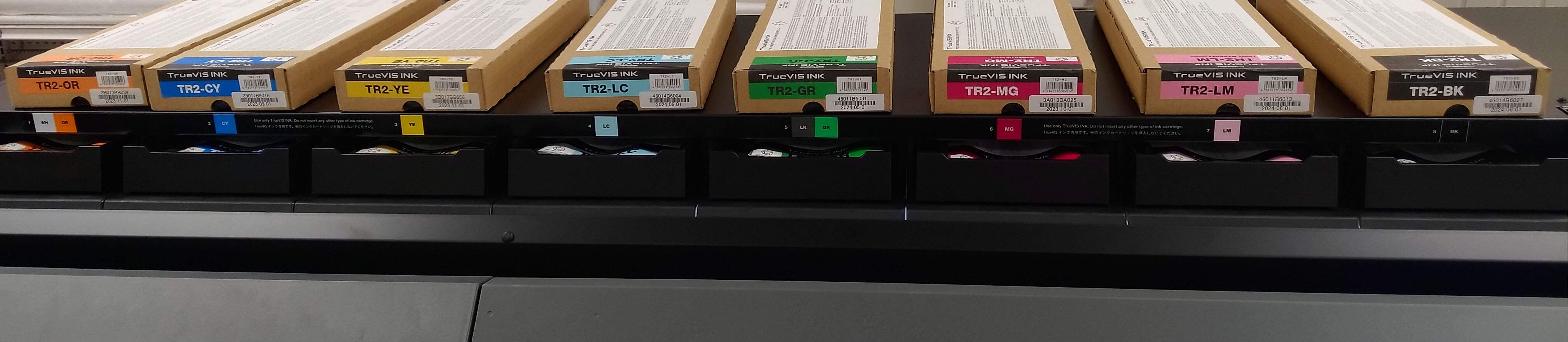

JamminSigns
Different ink setup though.

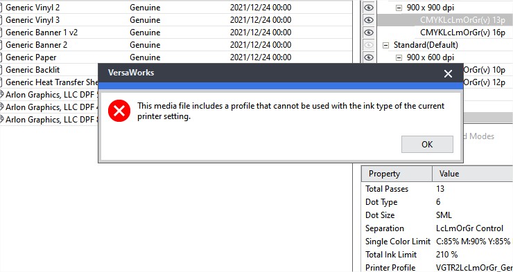

CMYK Light black Or Gr
I am using CMYK Lmagenta Lcyan Or Gr
thought it was advised to only use profiles that match your ink setup.
Plus that confuses me because Green and Light black are in the same tray. Yet that profile has both?
Edit: tried the profile you linked and it even reports it as so, cannot be used with the ink type of the current printer settings.

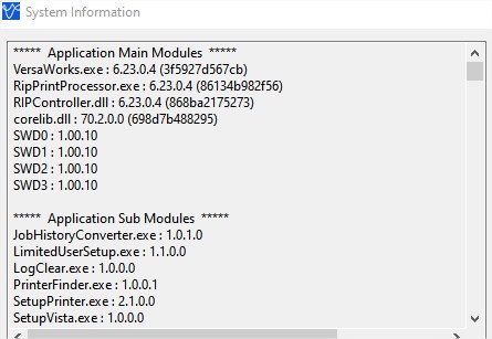

JamminSigns
Figured it out, VersaWorks 6.23.0.4 does not work with Avery Profiles ATM for me at least. Tested on 2 machines.
EDIT: Got in contact with Avery's ICC side and they have reported this as a known problem that is on Rolands VW's side. Either rollback or wait for Roland to fix it.
Another 2 I have running 6.14.0.5 & 6.21.1.0 Profiles work.
