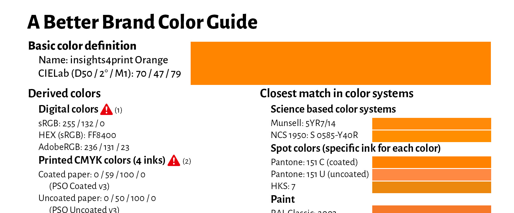

The main alternative to Pantone is to simply ask people to measure the color they want
and supply the L*a*b* measurement to their print provider. ASE files consisting of names
and spot color L*a*b* measurements can also be compiled and used as a communication
between print customers and print providers.
Some info that may help in understanding more about this:
