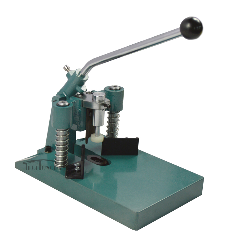

    The Image One Impact Sooper Corner Rounder is $600+ but there are several "China" ones on Ebay for 1/3 the price. Not big into buying the knock off but does anyone know if the knock offs or is IO Impact rebranding another machine. Also this style only goes up to 3/8 or 1/2 I think.

    We have of the china specials, 1 with 3/8, the other 1/2. Theyre a bit of a pain to square up the die when you get them but once its set they work fine. 3/8 works good,1/2 doesnt do so well with acm and 063, it works but is a little tough. Not worth much more than $100.

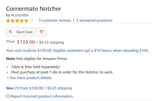

    We use accucuter conermate ours is the one that is good for 080 same die for 8 years.
