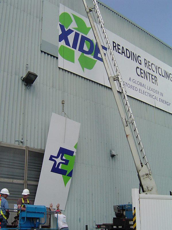

attachment.php

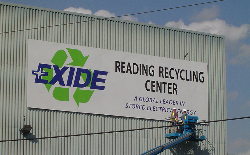

This thing is 12.5' tall and 40' wide. It has screws about every 6" top and bottom and a foot at three tiers in the middle, if I remember right. That thing is about 40' to the top and right by the side of a road. You can't see a single screw and we didn't paint them white, either. That is all hand-painted.
3mm ACM 5' x 12.5' pieces. The seams are there. Believe me.
What most people don't realize or understand is..... if you take your time being careful to make sure everything is perfectly plumb....... people from a few feet away do not see the imperfections like seams, screws or anything else, as the copy or graphics become the focal point and no one notices the little stuff. It just doesn't register on the mind's eye. Even if you are looking for imperfections, they aren't gonna be noticeable.

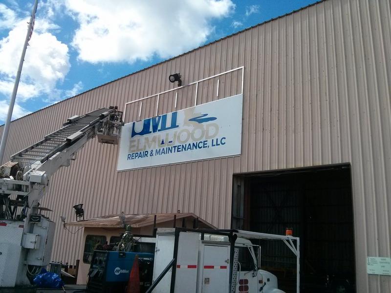

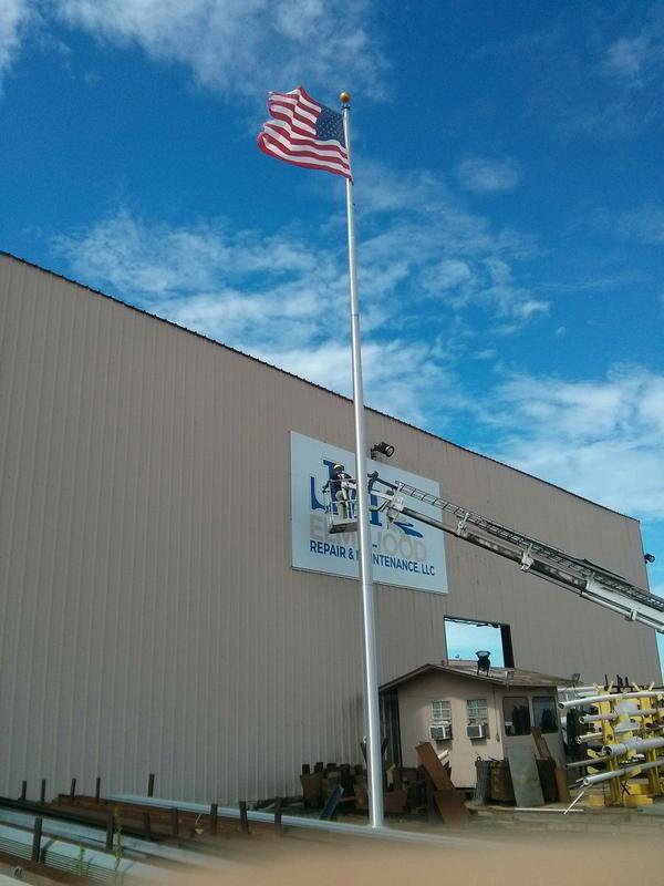

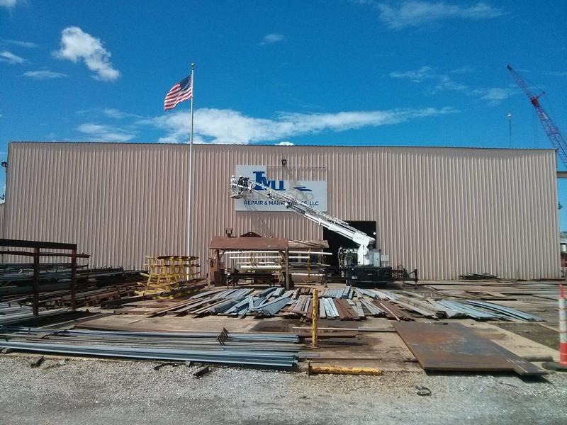

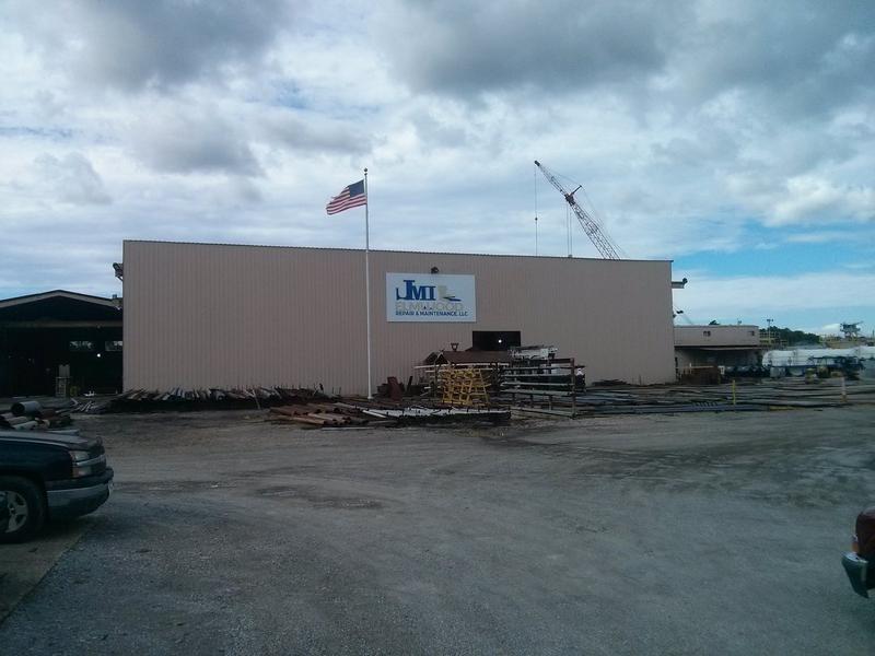

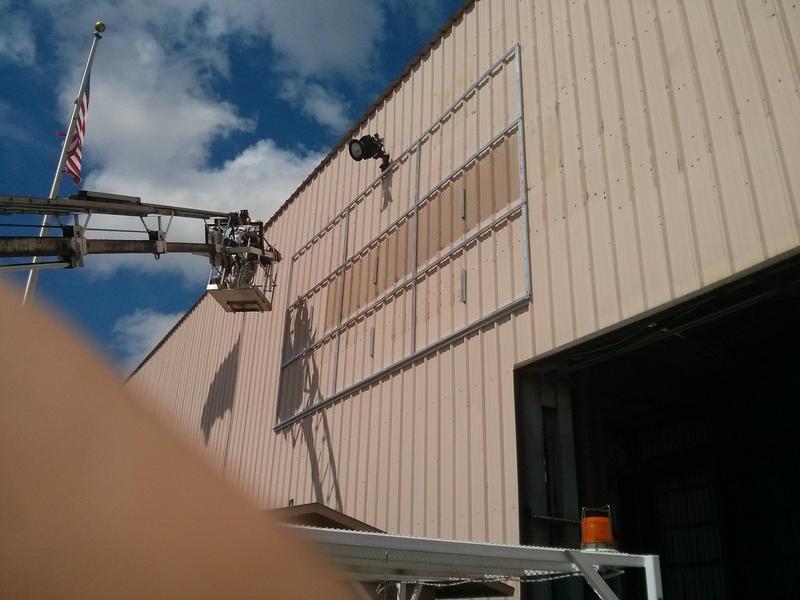

Thank you.
attachment.php
attachment.php
attachment.php
attachment.php
attachment.php
