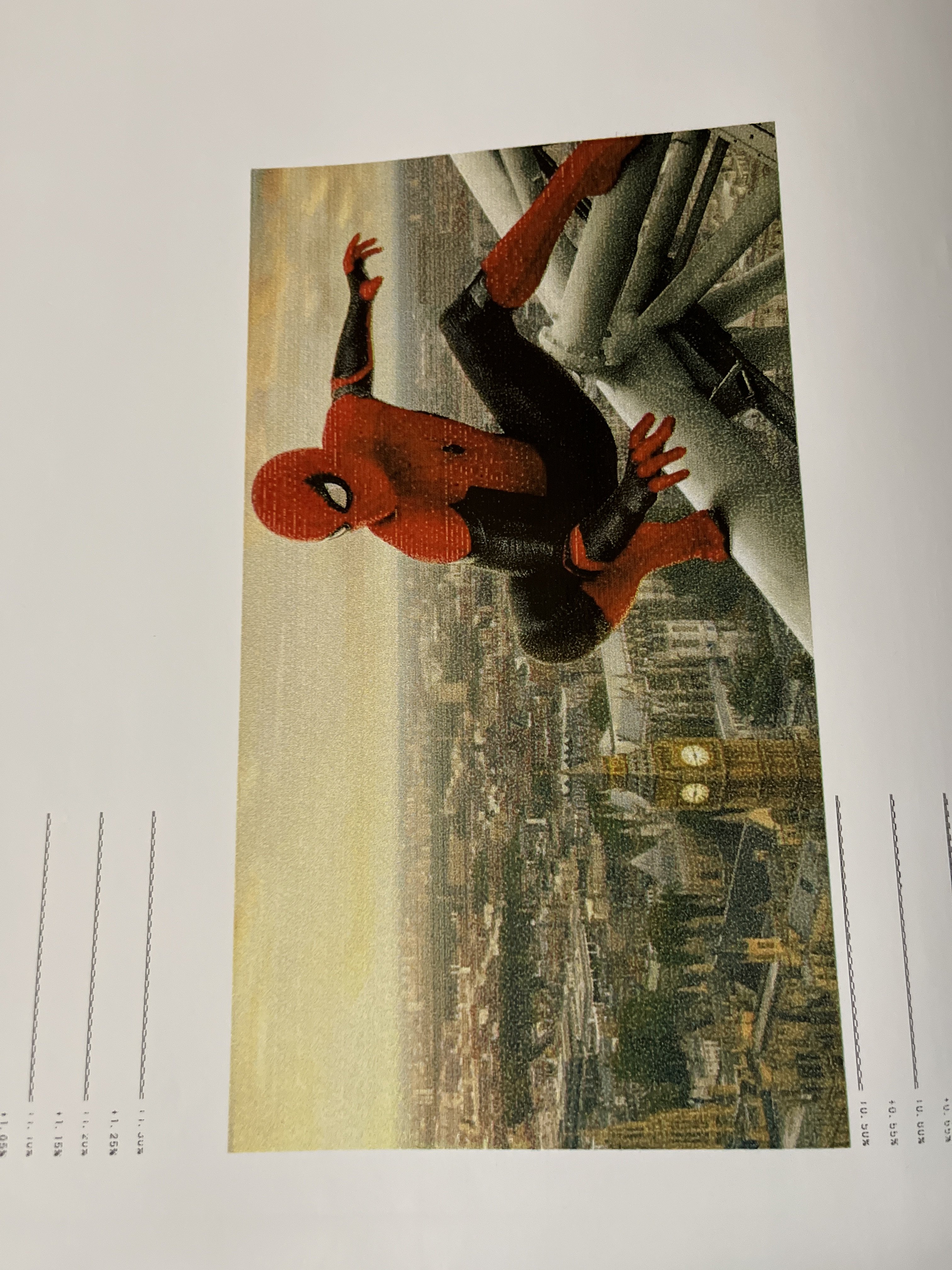

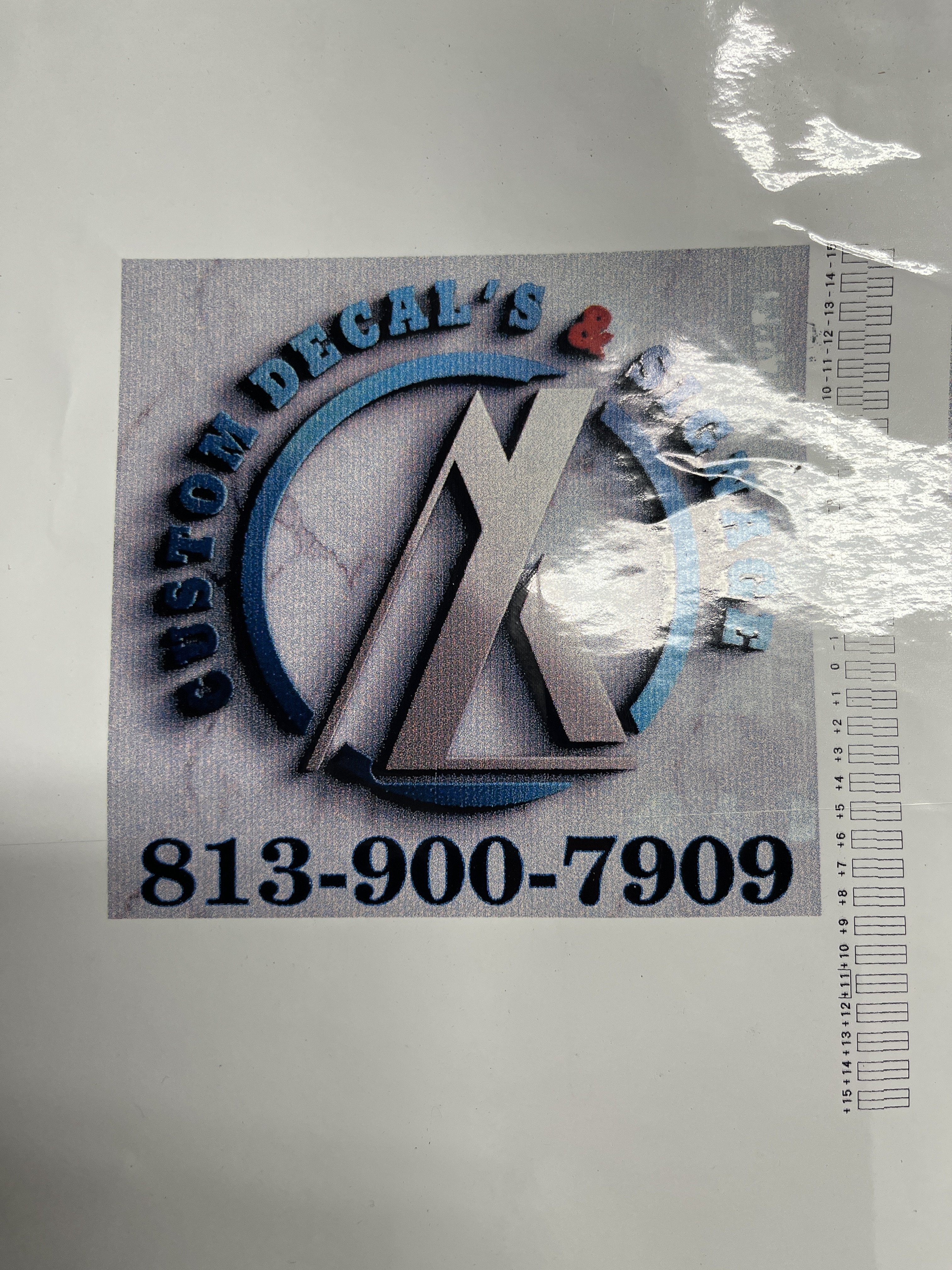

Have I just put two head in my sc500 and having banding issues I have calibrated done all kinds of things can anybody help me to fix this my output profile is FMX press are use flexi 8 a here is a picture of the best I have been able to get it the business log is how it started

Ok so are u saying it needs the profile fix ? I have a old school sc500 and just replace heads and getting banding and it looks like cake up on material and on top of it and not on it after playing with setting this is best I can get it any help would greatly be Appreciate it
