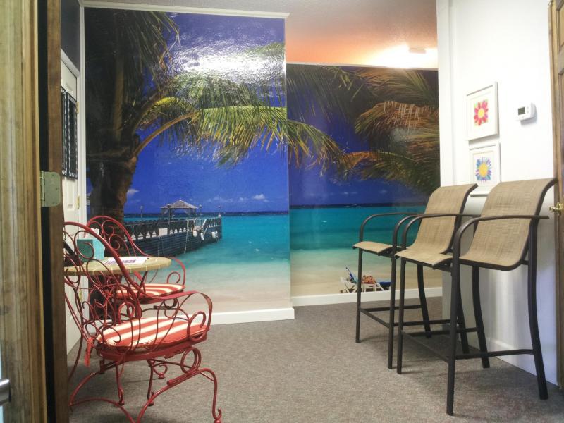

Laid down some Kilz today, will get you guys pics once everythings painted and wrapped :thumb:

I had the same problem with a customer. My wall was very textured so that just made it worse. Ended up scuffing and priming everything to get anything to adhere along with a lot of heat.
