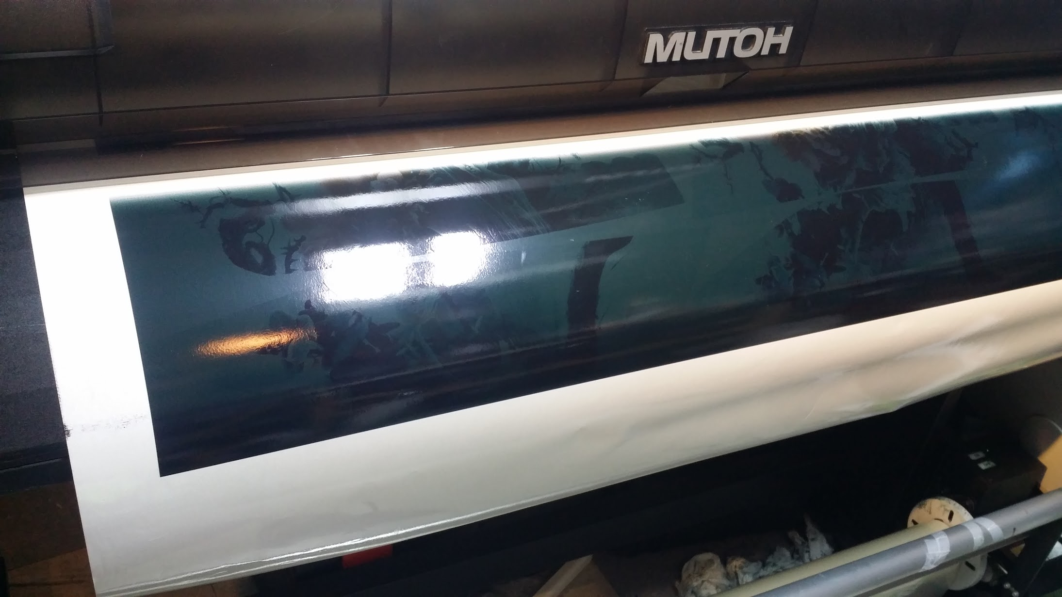

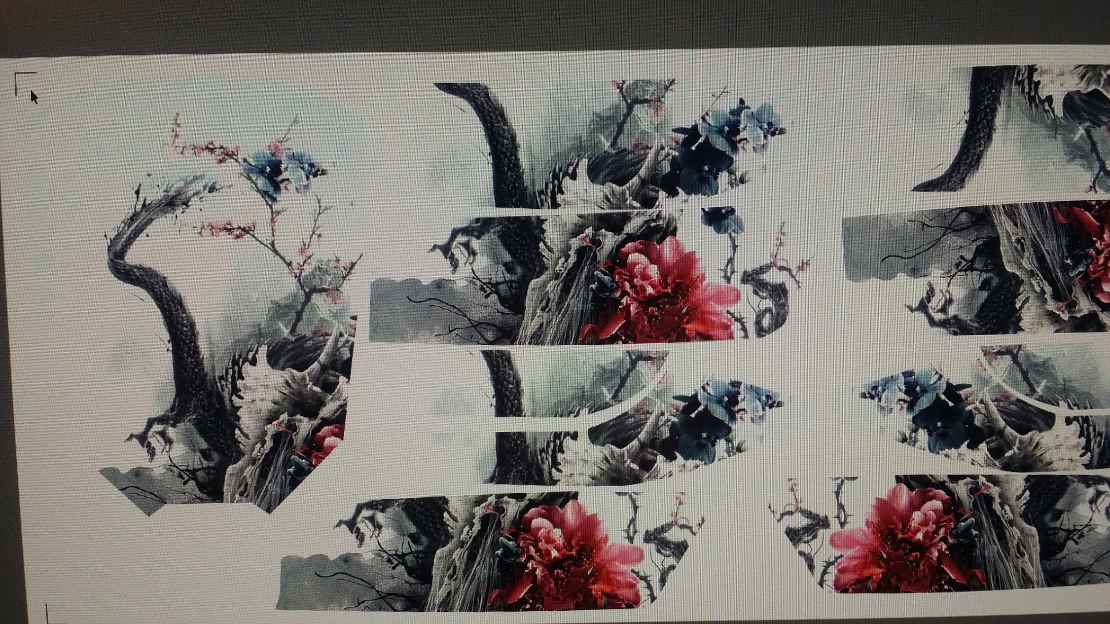

OK I've printed this layout many times before now for some reason it want to fill in the background. Import to flexi from coreldraw been working fine. Did I change something by mistake!!!! WTFH!!

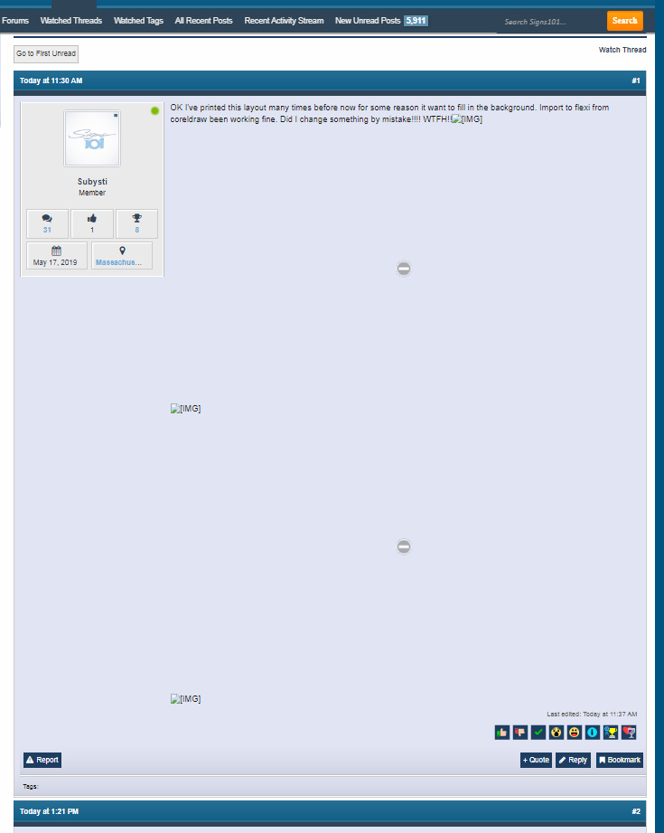

hmm maybe so. I can see the 2 images fine, you can't? Basically one image is a screen shot of what it should be printing and another pic of the printer just printing big blocks where the whole layout is.
WildWestDesigns
The images actually showed up in Firefox on my desktops the first time I viewed the thread, but when I went to look on the replies on my phone (which I also have FF on), that's when I got the broken links. Now on the desktop it shows just empty IMG tags.
unclebun
Your IMG links are to your own hard drive or something. You didn't upload the images using the forum "upload a file" function.
It looks like it's overprinting a transparent black on top of the trees.

The images are uploaded to google. One more try. unclebun why is it now printing a transparent black over everything? I've printed this fine many times before.

Ok so I solved my own problem but will post here to maybe help others. So I don't know how but the profiles in Flexi rip and print (3 of them because I tried multiple) all had the color adjustments changed. It's a little odd how it does it also. The first screen has "all colors" selected and they all start at 0% and go to 100%, but when you select each individual color the scale starts at 40-60% and went to 100%. So each color was seeing a 0% input but printing 40% or so out. I don't know why when all colors are selected as an option that it wouldn't override the individual selections. Also don't know how or why they changed as I've never fiddled with them before but I was going through every window and every box to figure this out. Checked 2 profiles so far and they are both changed. Thanks Flexicrap, about $80 of reflective vinyl wasted.
