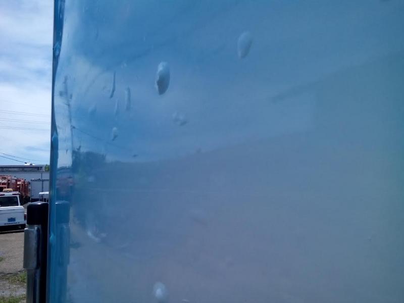

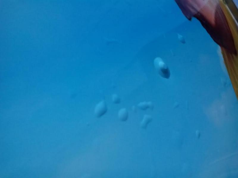

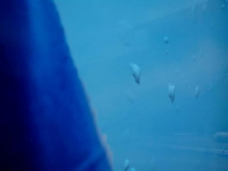

Here are the only pics that are actually clear enough to see the bubbles.
To make it even weirder on one side of the trailer one installer did the first panel, another installer did the second panel. When we delivered the trailer last week (they had to have it bubbles and all for an event) both panels were filled with the bubbles. Go by there today, the first panel is smooth as glass, the second panel is full of bubbles. They are on the same side of the trailer getting the same amount of sunlight everyday.

HulkSmash
Install Error, Wrong Material.. etc etc etc.
There's prob moisture under it now, so those won't ever stick.
We stock the IJ40, but don't use it very often. It's our cheap go-to stuff for a quick down and dirty flat kinda job. Reading up on it, it's for flat or slightly curved surfaces, not rivets. Perhaps your two installers have different approaches to wrapping. Earlier I mentioned about post heating. That will help and prevent a lot of lifting afterwards, but some of that just looks like bad technique. Once that stuff is down, the whole surface needs to be heated and squeegeed quite sternly. That is important.
LarryB
I would not have used a calendared material. We only use 3M IJ180 CV3 for vehicles and trailers. The shrinkage on the calendared material will be obvious after 6 months.
CanuckSigns
first off, IJ40 is the wrong material for the job, if a cast vinyl isn't in the budget, I would go with something like AutoMark by general formulations, it works very well on trailers and handles rivets quite well.
Saying that, the issue you have here doesn't look to be a material issue, I would agree with Colorado signs and say it's an installation issue, are they guys who installed this experienced? Not trying to sound like a jerk, but it looks like a rookie install.
