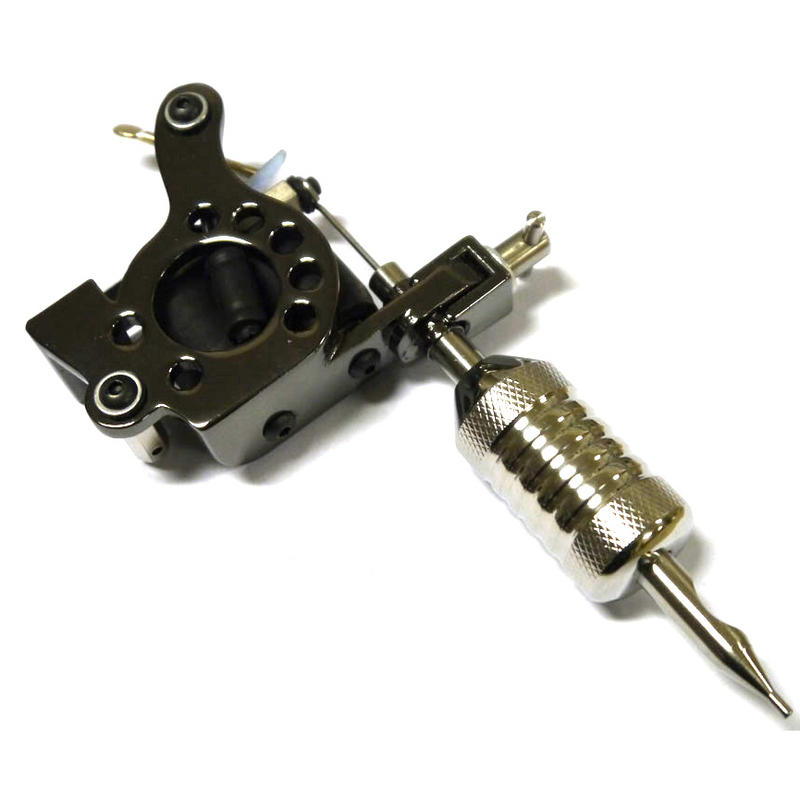

To fix the bubbles that are already there get one of these:
They will poke several hundred times per minute - shouldn't take long to clear a few thousand bubbles......
