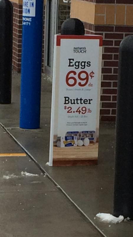

Looking for a vendor referral for signs similar to image. I did not see any on Signs 365. We could make these in house although I think it would cost less to outsource. Suggestions? Thanks!

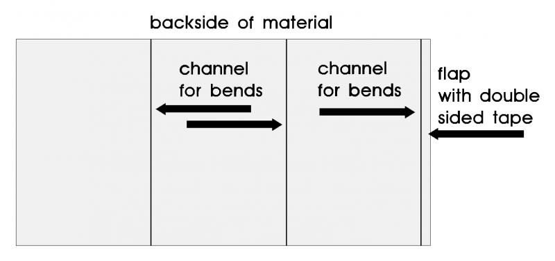

have the print done as an outsource and then create a channel on the backside so it can be bent. it looks like it is held with an extrusion which you can problably find at Outwater or just have a small flap that can be double faced taped.
Billct2
We would make that with three pieces of pvc with three pieces of "triangle" molding from Outwater Plastics.

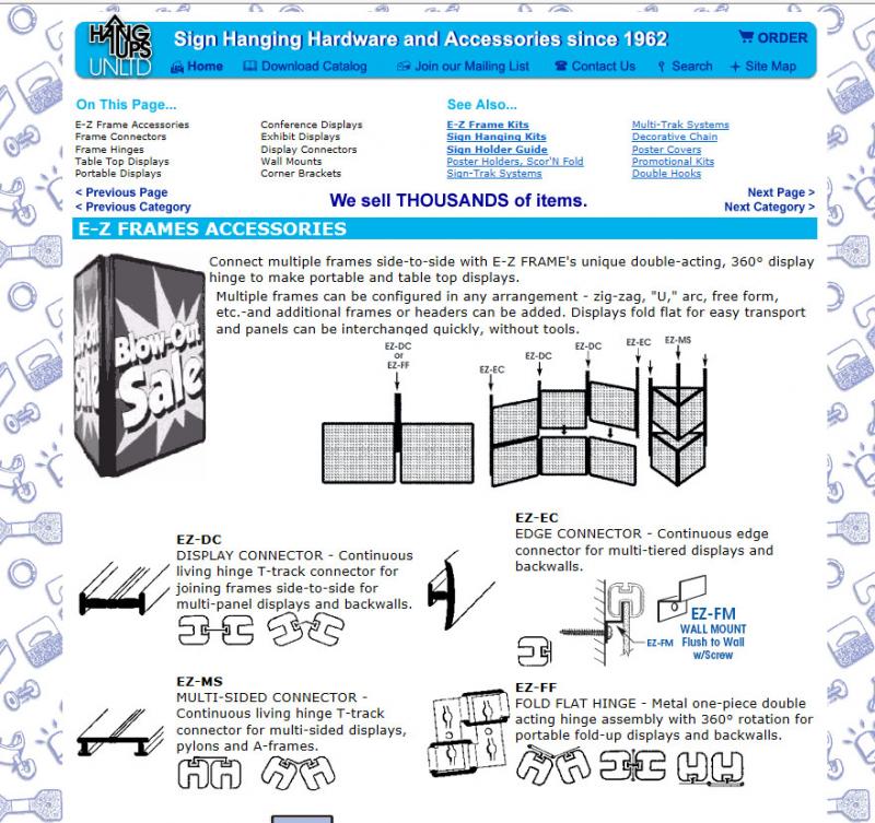

you can try Hang Ups Unlimited and see if their e-Z frame accessories will work. if not, I'd do the channels on the back and on the last panel have a 2" or so flap that overlaps and double side tape it or plastic screws

the more budget friendly option is to print onto CorPlast and then cut the flute on one side so the three sides are of equal size and then you will need a fourth piece that is the width of VHB Tape to secure the triangle and keep from opening

Yeah, those are just 3 pieces of coroplast and three readily available pieces of corner strips.
