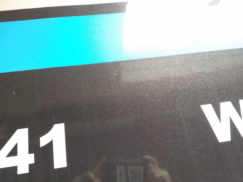

mjkjr
I've attached an photo I took of the results. Seems like even pockets of air throughout. If your eyes aren't at an angle to catch the light you can't tell, but when you ARE, woah-boy is it bad. I think laying flat is more prone to this at 90 degrees as it will be used, so maybe not a big deal? Not sure how it's going to last though, and that worries me.
Any more suggestions as to what I can try would be greatly appreciated.

Malkin
Have you tried adjusting the laminating speed down? Whenever I had this issue, it was greatly improved by the slower speed.
oksigns
I would go super slow, keeping a good amount of pressure as it appears to be dense film, and relaxed tension on the roll to keep the film as relaxed as possible. MAYBE even a sled underneath of addition height(if you can manage it) to add some additional pressure.

mjkjr
Hi Guys,
I did notice in a few spots on some test pieces that I ran through, where I had jogged it (stopped for a moment and then started again) seemed to to have a strip that looked a little better, so maybe slowing down is the key.
Here's my problem with this though: my laminator (38" Daige QuickMount) doesn't have a speed control to slow it down - do you have any idea how I might be able to slow it down manually?
