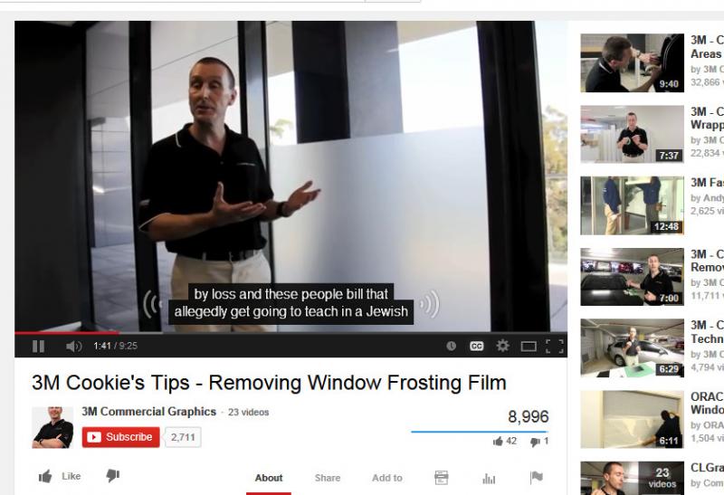

Old mate Cookie has video of the soaking deal. Never done it personally it but looks like something worth trying.

If you're scraping wet the whole thing down with soapy water so it falls off rather than smears.
http://youtu.be/vqI2nEj1vo4
This is from the tinting world - to remove rear window tint while trying to save the painted on defogger lines.
We use a strong ammonia solution & cut trash bags to help soften things up.
What makes this clip even more informative (& entertaining) is turning on the "auto closed captioning".......

That video is helpful if you have 2hrs to wait. By that time you can be done job.
