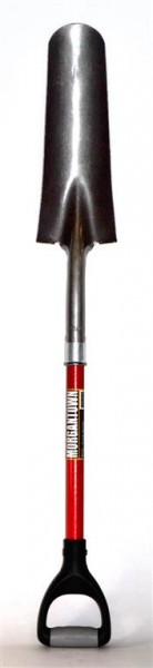

a narrow shovel for trenching or most narrow digging jobs
If this is what you are talking about the correct name is track spade or more recently known as drain spades.

Moze
Precision Sign Services
If this is what you are talking about the correct name is... track spade or more recently known as drain spades.
...or sharp shooter, tile spade, hot shot, Bill Dookie, the list goes on...
There are a ton of "correct" names for it.
