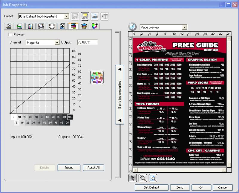

What I do is go into the channels and change my Magenta value.
By fiddling with the colors individually like this, I'm actually able to get a really neutral gray.
My reds are pretty weak at the moment... but I think it's something with the printer, and not my profiles.

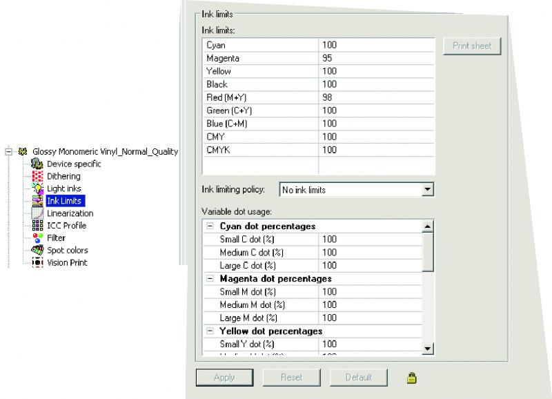

i did lower the magenta value in rip profile, and now lighter gray is better, but darker still isn't! obviously i should lower magenta a little bit more! And also reds, i think...
my settings looks like these...
