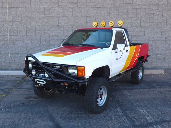

I'm going to install some stripes on the rear of a 4Runner similar to the attached. Question is... what's the best way... I already printed and cut it, but not positive if I want to pre-mask it. My concern is keeping the stripe spacing uniform without premask but dealing with having to conform (I think it'd be minimal) if I had to... with it. Any tips?
What I'm putting on the red (rear stripe) doesn't "wrap" the rear of the bed. It's just another stripe which is a little wider than the others.

Cut your vinyl a little wider than you need for each stripe. Before applying, use knifeless tape to layout your stripes. Apply the vinyl over the tape, pull it all up and you have nice clean stripes with uniform spacing.
