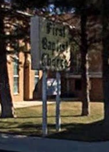

A church is needing to replace a sign that I believe is fiberglass that is translucent and corrugated as shown below. The other pic shows approximately the shape of the fiberglass. I'm guessing the sign is 40-50 years old. They asked me if I can replace the translucent boards with something new and put graphics on the boards for them to update the sign. I'm not sure where to begin for material. I'm guessing the sign is 5' tall by 6' wide. I've got an builder/electrician that will help me replace it I just need to get 2 substrates and the graphics. Any suggestions on the materials that I could use? It would have to stand up to high winds, etc. Sorry for the picture, I got it off of Google street view. Thanks for any suggestions.

yeah! they dont use that any longer, replace with a pan face OR a flat lexan face if the sign will allow.
For the life of me I never understood those damn panels BUT they sure did last!

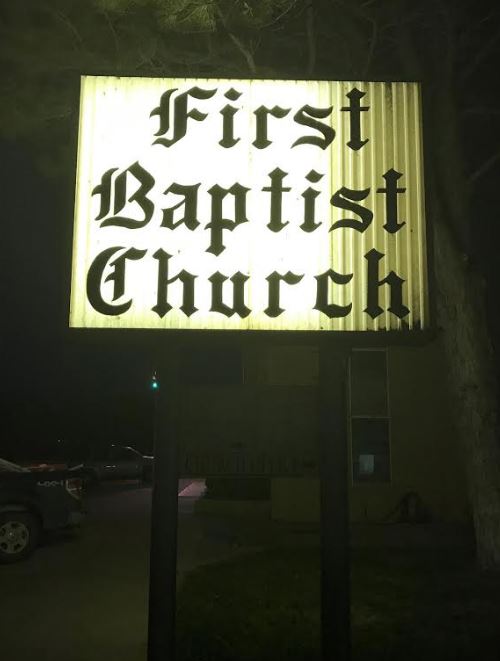

Is there any thickness or level of translucency that you would recommend? Here is a night time picture of the sign.
visual800
A regular panface should suffice in the white it comes in. Looking at your pics we need some new bulbs!
Probably a new ballast, too.
You're gonna hafta go there and get accurate measurements and while you're doing that, check out the size opening for the face. Many times, those old faces utilized a very wide gap to accommodate the tops and bottoms in the lips. You'll either hafta shim or retrofit a new lip portion all the way around. There are quite a few aftermarket items you can look into right here on s101 to do the job. Do a little research (search button is your friend) and check out the possibilities.
