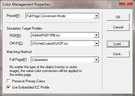

For the transparency issue (color change inside the rectangular area of the transparency) the solution is to use a specific Color Management setting in Versaworks, called Full Page Conversion Mode. It is located in the Job Settings dialog > Quality tab > Color Management Preset list box. See the attached for more info on the default rendering intents used with this Preset.
In my experience, this resolves the transparency issue in the majority of cases.
