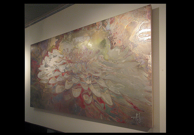

in the attached picture, this piece is a $5000 piece, blind cut after mounting the image (etched and printed aluminum, mounted to 4" deep pine beams). so yes, the entire image plus base was cut in one pass at an angle. you would be crazy to risk a part like this by putting it in a saw. but i plopped the guide down on the whole thing and chopped off the chamfered edges. no scratches, and the edges of the wood looked like i'd sanded them with 200 grit. perfect smooth toothless cut.
