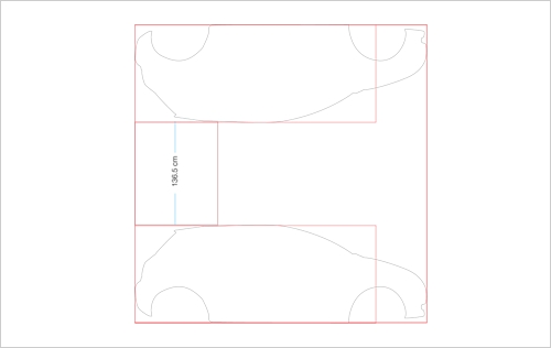

Use template software, badwrap for example its not that expencive It will do the work for you, all you do is make the design and when its done It will lay It out for you to just print It out
Have you actually done this? Bad Wrap, etc will NOT do all the work for you. It's typically much more off then templates we build ourselves (vehicle dependent)
And it certainly won't do 3D transitions and can not take the curves, turns, bends, etc into account.
