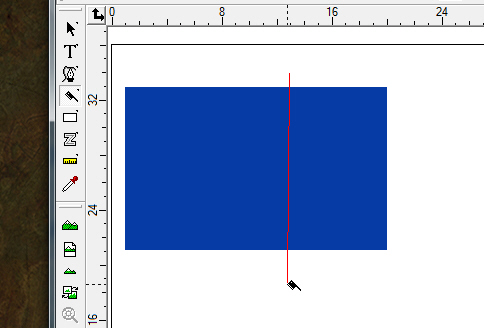

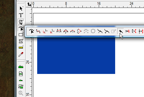

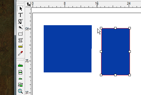

    Here's one method . . .

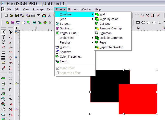

    If I understand your term "triming" (trimming) correctly, the commands in Flexi are all under Effects > Combine. How they work is explained in your help files but they are governed by colors and layer position so an exact explanation will be different with each different combination of factors.
