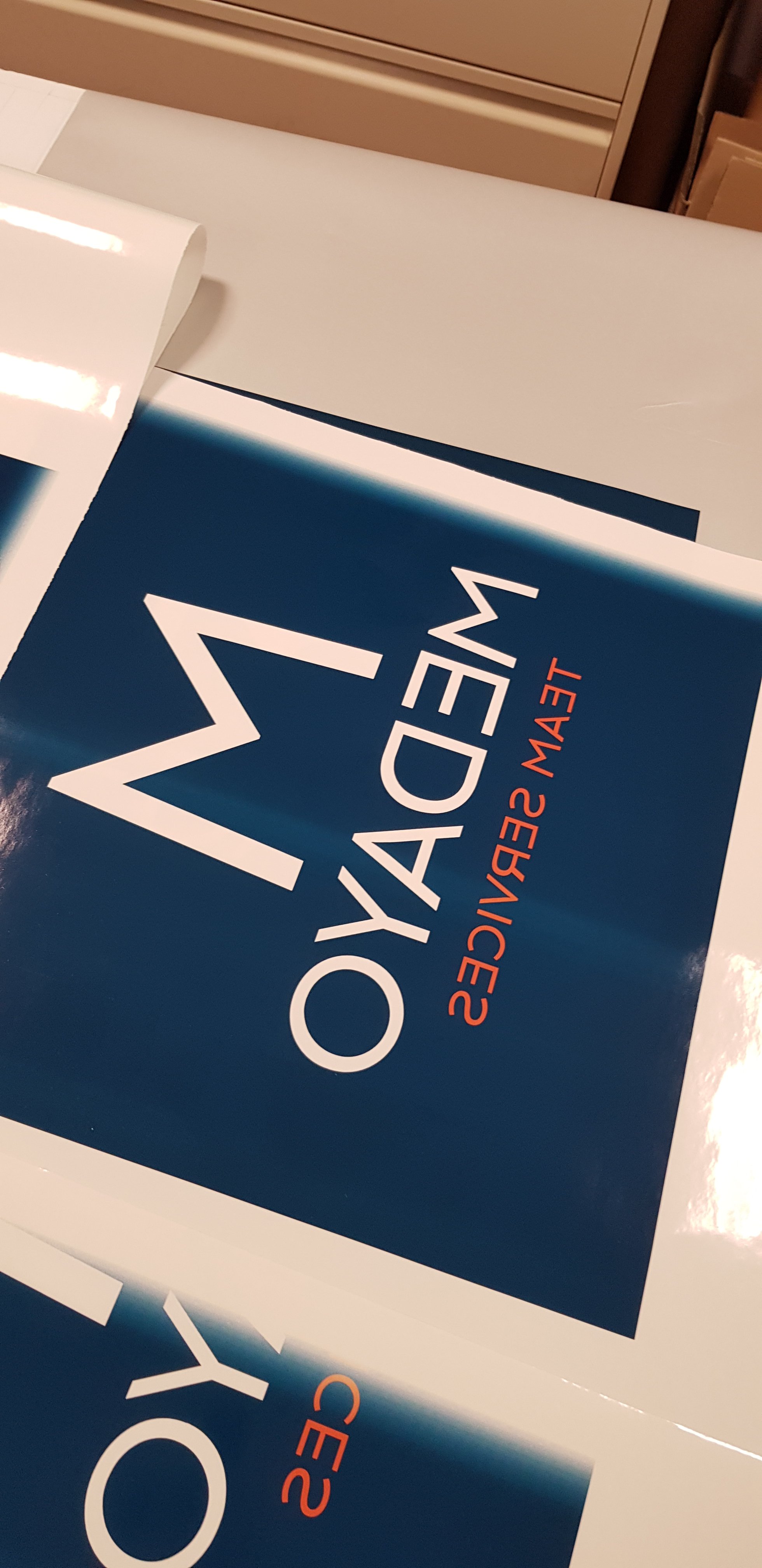

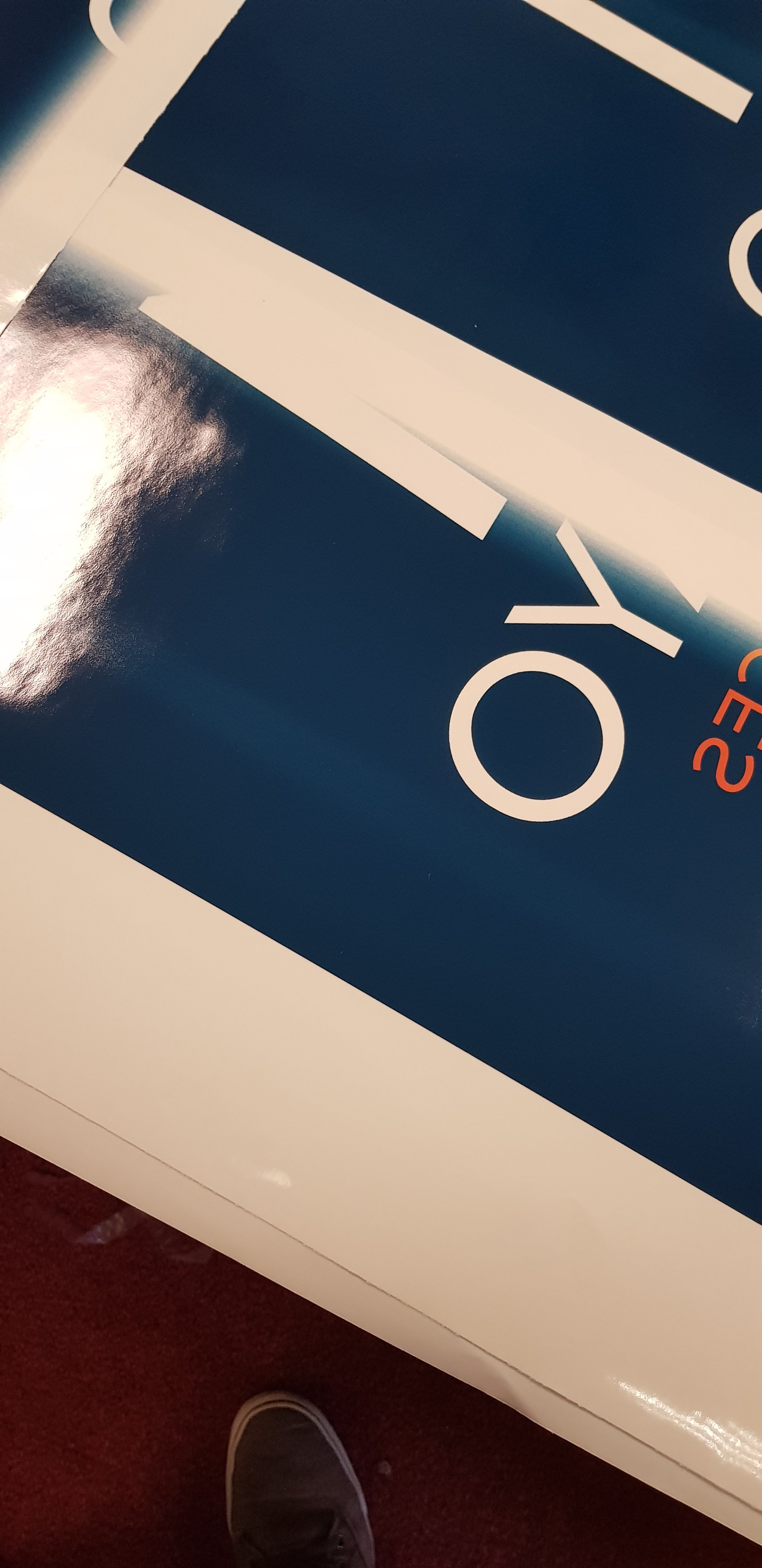

Hi all,
I am a newbie to this forum and hope someone can help?
We have a Roland Truevis vg640 which is a warranty replacement for a VG540 (that has the same issue).
We have continuing issues with banding (lightpass banding as the engineer calls it) and cannot seem to get rid of it (see images below which show problem, although this is a mild example of it)
Lots of tests have been carried out with no solution. Most recent suggested possible cause is static?? Have tried antistatic cord this week, however it still is appearing.
Should have said, most noticeable on self adhesive vinyls, although still appears on roll up light block too and some others..
Waiting on further comment from dealer.
Any ideas?
Thanks
AD

Try printing unidirectional. If banding goes away or is greatly diminished there are ink delivery issues.

Hi Captandy - Sorry you are having issues with your printer. Obviously, this forum is limited in what we can figure out, but please feel free to PM if you like and I will get you connected with our service department. In the meantime, a couple ideas and suggestions - first, if you are not printing in Low Head Height, I would recommend trying that. The higher setting could be causing this type of issue. Another thing to try is to add more pinch rollers to improve the feed accuracy of your device. It's possible that slight media slippage or drag is having some sort of negative effect. You could even try printing on a sheet of media as opposed to the roll to see if your feed assembly is giving you problems.
Static is public enemy #1 in large format. I know you tried the static cord, but also keep in mind temperature and humidity of your facility. Being summer, I don't expect that this is a problem, but make sure it isn't too cold or dry in your facility.

Thanks for your reply, currently dealing with service in the UK. Tried your suggestions to no avail unfortunately. Humidity is not an issue where I am, so that is out.

Did you ever get this issue resolved? I have had the same issue off and on for the last year with a VG-540. It comes and goes, but I have never gotten a solid answer from a tech or from Roland. We went through ink lines, dampers, cap tops, Ink line filters?, encoder strip, feed motor. They changed everything they could think of, and the problem still pops up occasionally.

Hi.
Problem seems to have gone, thankfully. No definitive answer as to what was the cause, possibly due to static. We changed the carpet to laminate floor, changed the cutting strip to one off of an XR as it is not PVC based, and upgraded to VG2 inks. Not had the issue since. Hope this helps.

I've have had the same issue. What works for me is slowing the head speed down in rip. I think the generic default is 1185. I have gone as low as 800 with great results, albeit slower. Also turning down the print heater a bit helped me a lot. Same machine for the record.
