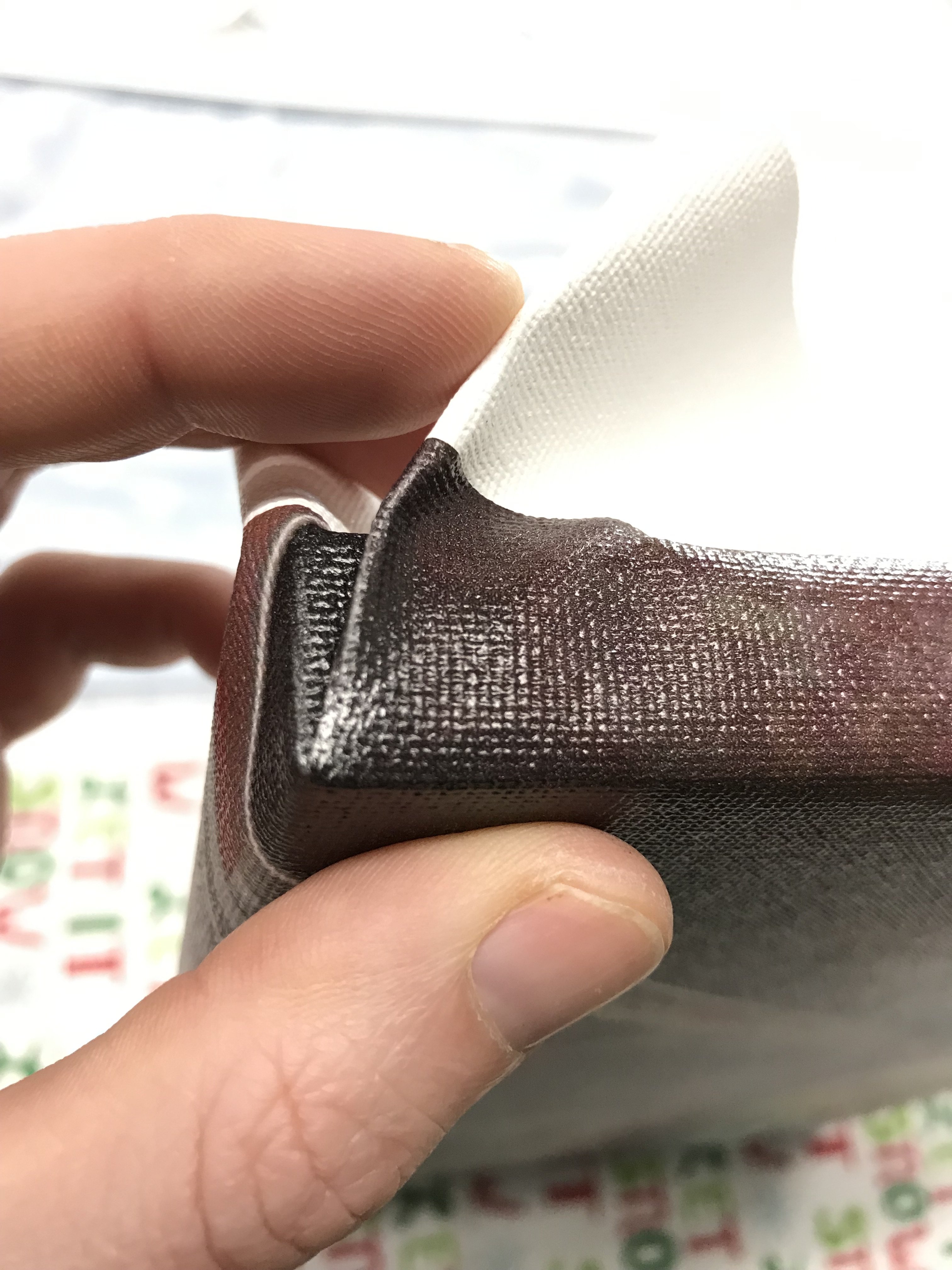

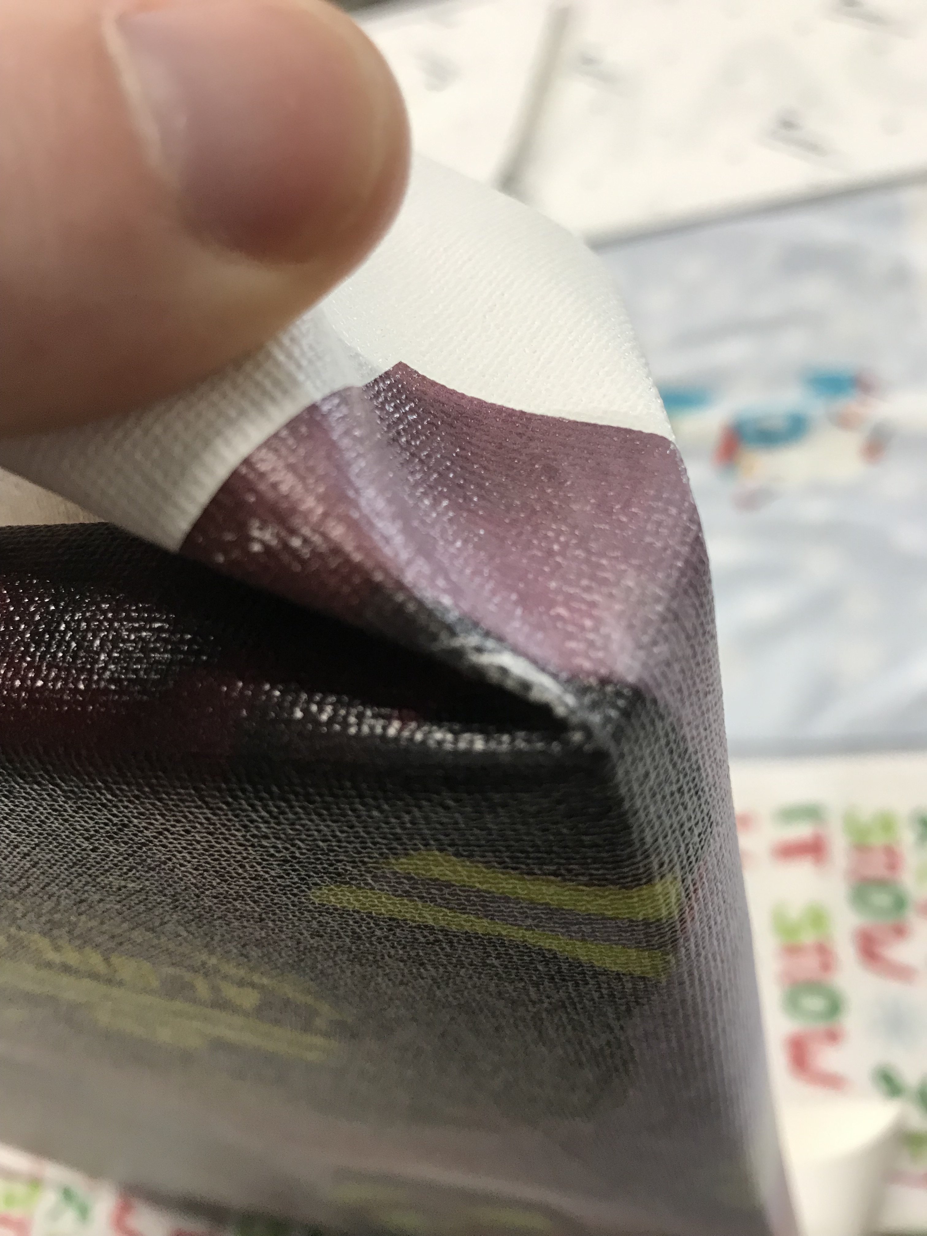

    The ink rubs off and scratches super easy. Never had this issue before. If anyone has a good profile or can help me out that would be great.

    I don't think I've actually tried canvas on the VG yet, since it's extremely infrequent that we get requests for canvas.
    The bad quality, and tendency to rub off, remind me of the time that we were accidentally sent a roll of Phototex for Latex printers, rather than Solvent (might have been mislabeled? can't remember). Do you get the same results with another roll?

    That's odd for a solvent to be able to rub off... it should be embedding itself into the coating.
    I was just about to ask the same question as Malkin... are you 100% sure it's a solvent canvas they've supplied you with?

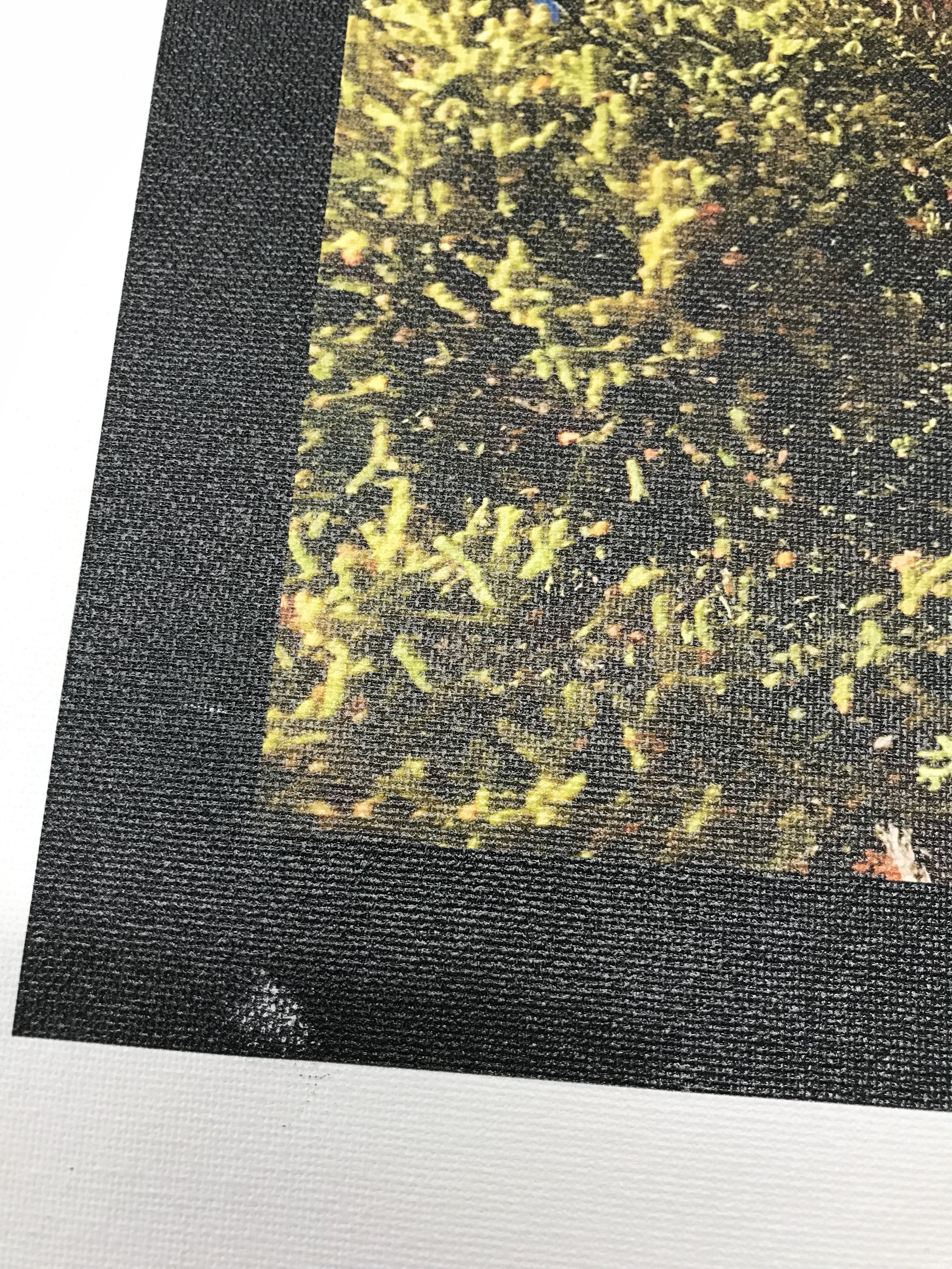

    100% sure. I did just retry to print pre 40 post 50. uni mcvp slowed head to 760 hopefully that will help. Colors look a little more filled in then yesterdays print.

    The ink just falls off. Does tru vis not stick to canvas or what?
