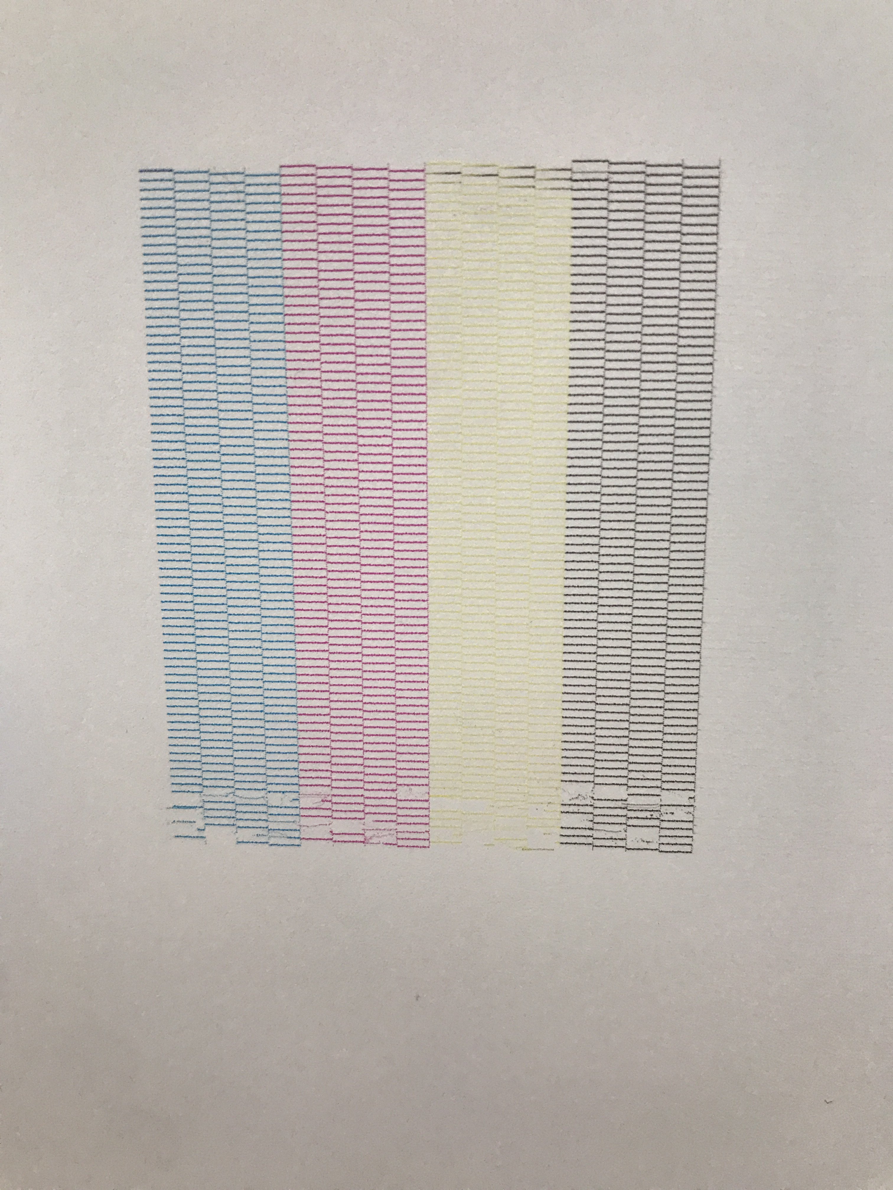

I have been printing with a Mimaki UCJV300 for about 18 months now. A couple of days ago the head gotcaught on the media, it basically touched it, as the vynil wouldn‘t stay down, but it kept printing. It left a lot of ink on the media, so I presume it printed with the media „touching“ the printheads.
Well, next day I had a couple of nozzles missing but I didn‘t think I would be s problem, but even after all the possible cleanings I could do, they woun‘t come back.
Now I have:
- a bunch of missing nozzles and some that are weirdly printed;
- And I noticed that the cap station is messy, there is color around the cap.
I have already read every possible post I could find but nothing.
I did a manual clean on the heads yesterday, but still nothing. I‘m not sure though if I did it right, I was afraid of damaging it.
Could anyone help me, cause I‘m out ideas. I have multiple printers and I have seen media jams and this kind of thing as well, but I have never seen a printhead being damaged that „easy“, if that‘s the case.
Im attaching a foto of the test print, so you guys can have a look.
Thank you and hopefully someone can give me some insights.

Did you try a nozzle wash? If not, start there. You can even do an extended wash by turning off the machine when the wash countdown begins. You can try 15-30 mins or longer. Then do a couple cleans (normal, hard, etc..)
You could also take a foam tipped swab and dip it in cleaning solution and wipe the head in 1 direction.
Kind of looks like the ink dried on the head

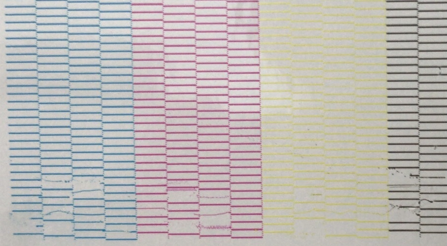

I try printing today, and the print is good, but the nozzles are still the same. Actually, today I took a look at all the test prints i‘ve done, and the nozzles missing are not always the same. Some i could get back, but later on they were gone again.
I‘m just trying to unterstand why I have those strange lines on the test print, as oppose just to have blank spaces where there‘s a clogged nozzle.
Could that be „dust“, maybe because it scratsched as it kept print even if it was touching? I‘m attaching a close up photo in case you guys didn‘t noticed it.
My technician told me that of the top caps are not sealing good enough, it would make harder to get a good clean, he also told me that sometimes nozzles may recover after some printing?
Any thoughts?
Thank you for your help

I single head strike is usually recoverable but if the head slid across the vinyl back and forth for an entire print, that could definitely do damage to the nozzles. I'm also seeing cross contamination in the yellow which is a sign that either the cap top/pump isn't working 100% and/or the head is damaged.
Once you get it taken care of, make sure to have the tech adjust the media jam sensor. It should have tripped and not allowed so many head strikes to occur.

I'd start there just to make sure you're getting the best suction possible. If that fixes most of it but there are still some missing nozzles, remember there is a nozzle replacement function that allows you to replace that nozzle with one behind it. I believe it's up to 10 per channel but that may have changed with firmware.

Did you take a look to the last pic i attached? Have you ever encountered those kind of patterns?
I‘ve been printing for abou 7 years with latex and mostly mimaki ecosolvent, i have to admit that i have less than 2 years experience with uv, but the pattern on the test print is annoying me.
thanks a lot.
