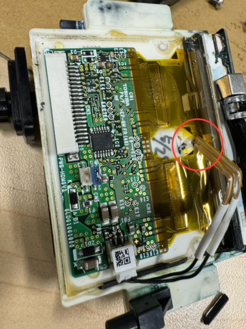

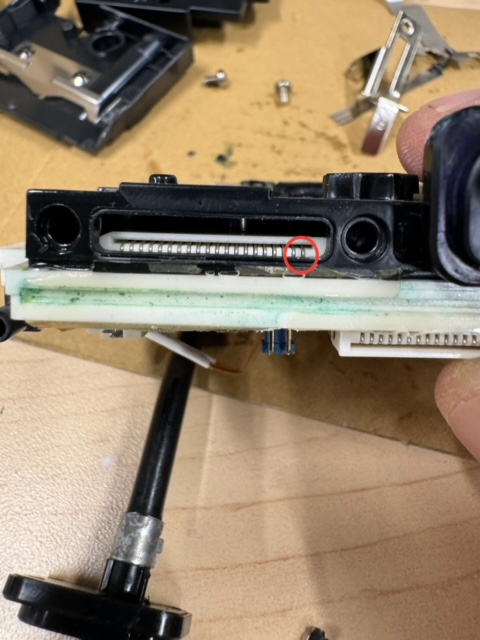

Thats how CE4 printhead looks like inside. The thermistor goes inside the ink chamber, glued there and cannot be replaced. But it goes straight to the printhead connector, pins 19 and 20, and theoretically, if you add a 9-10 kOm resistance between those pins the head will be constantly seeing 35-40C, in case if the head sees temperatures abnormally and causing errors

View attachment 174880 View attachment 174881
Wow, it's cool to see inside one of these printheads. Do you have any more photos or diagrams you could share? I'm curious about the heating block and what the hot water path looks like inside the head assembly.
could those resistors be added to the flat cable? scratch the surface to expose the copper trace, and add it there. should be safer to do like that, no?
