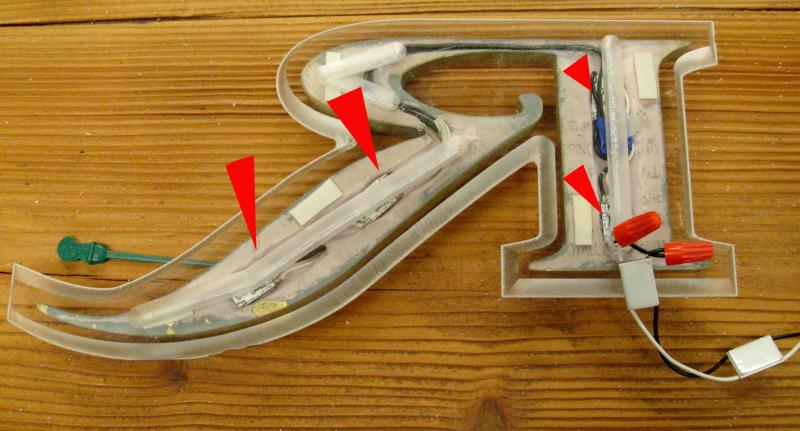

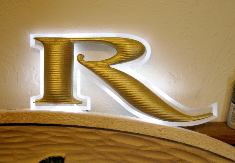

I have a semi large job in house that I'm planning on using this technique along with a 1/2" beveled plex background. See photo below as example of plex. I'm using Sloan LED's. I made a set of these a year ago without too much trouble. The client was happy.

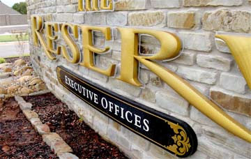

These are easy to make but it requires a router. I'm in the process of quoting a nice sized sign using this technique along with channel letter made with PVC. The best I can tell PVC channel letters are rare or new to the market. Since I have no metal working equipment or welders I'm headed in a different direction. So far it's been easy and fun.
The sample I've shown previously was to get the job shown below. Since time isn't on my side, I'm limiting some of my work. But not the fun stuff.

How are led's populated on the back of the letter pointin toward the plexi or vice versa ?
Joe Crumley
Thank you for the complement.
For those who aren't familiar with LED's they are about 3/8" X1.25" in size. Because they are so small it's possible to insert them in a .50" slot.
On these signs I route out a grove along the interior on each letter and there they go. It's seldom that I see letters with this effect and I often wonder why. They sell like hot dogs and I'm not in the electrical sign business.

My client who ordered the "Reserve" sign requested a light wash behind the letters and fill front lighting. The problem was he also wanted a stacked stone wall for the letters to go on. As you know, it's almost impossible to get a good wash from stone. For that reason I offered the beveled plex option.
This was my first attempt along these lines. It's led me to several other jobs along this line.

Because I'm making smaller letters it's important to have small LED's. These are placed in slots carved into the plex.
