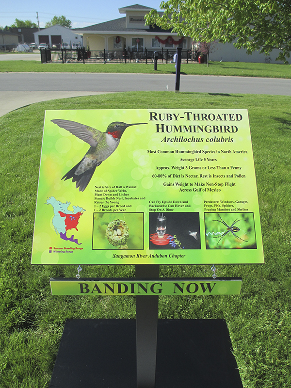

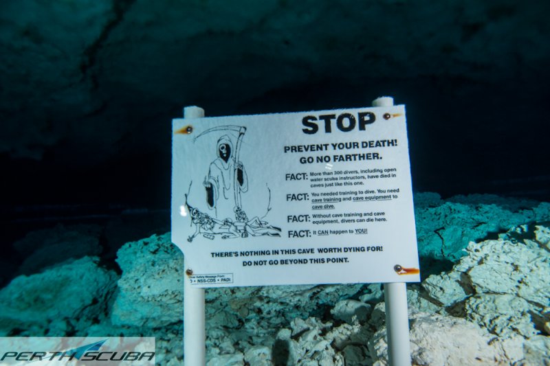

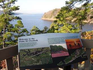

I've got a customer that wants to make underwater way-side exhibits for scuba divers to read while diving in a certain area. I've been looking everywhere online for information on if regular oracal vinyl will hold up underwater or if perhaps marine grade vinyl would work better. I don't believe any of the exhibits will have pictures, I think it will mainly be text, but if we did need to print certain images would you need a special kind of laminate/ink? I've found this one picture online of a sign underwater, and I've also attached a picture of the way side exhibit that she sent with her e-mail as an example... but she also said that she doesn't want to spend $1000 a sign like the way side exhibit she sent probably costs. Any information would be appreciated... thanks!

the lower example is most likely screen printed on what appears to be steel (due to the rusting)
edit: nm. rust is probably from the fasteners. the substrate is broken, possibly a plastic of some sort

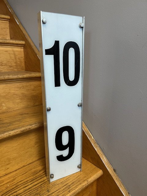

Ha! Zombie thread, I love it. But I actually had to do a sign to this type of spec since this was first brought up.
This was the sample we made. It's a Tide Marker for a commercial dock, bolted to a piling.
We reverse lettered on lexan backed with white, then the lexan was backed with 1" thick Azek thru bolted with aluminum angles.
Has to take a lot of abuse, besides being in salt water, theres a lot of debris washing with the tide.
Has worked well so far
