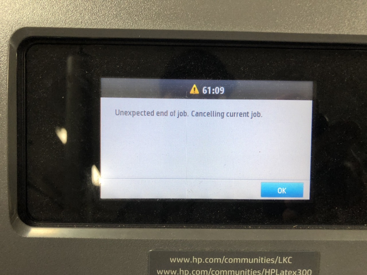

How much money in wasted material is this production manager going to cost me? This happens from time to time and drives me nuckin futs!!! Printing ij180 and 6ft in to a job production manager just closes itself and I get this error. I’ve had this happen plenty of times now who’s stupid idea at HP was it to have the data being sent bit by bit rather than just sending the whole print to the printer at the start?
I’m updated to the latest firmware as far as I know, this has been a problem on every firmware I’ve had since I got this machine a year and a half ago.

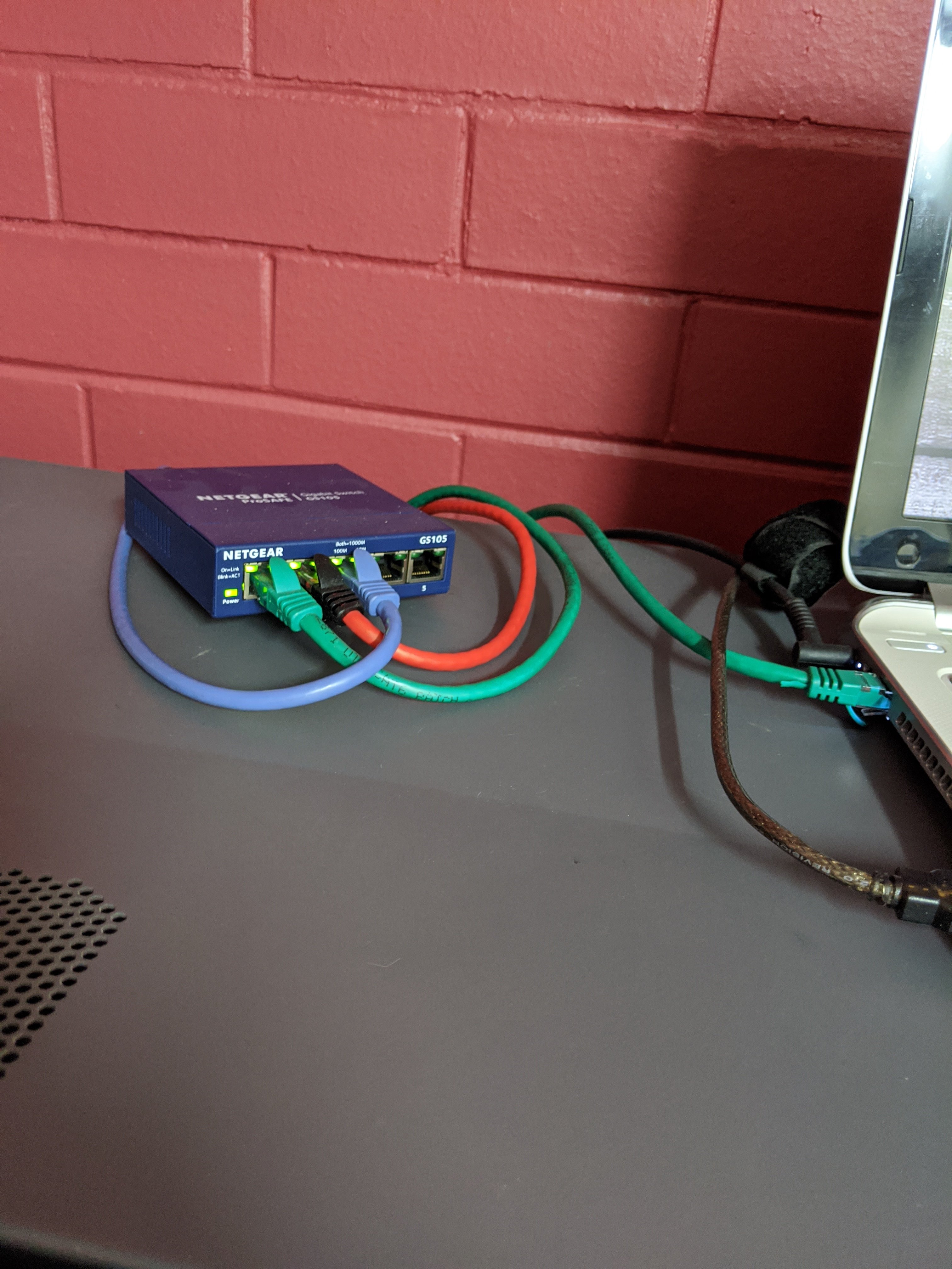

I started having this issue when i moved my printer. Previously had no issues. Printer was connected straight to computer running flexi. Drove me mad because i would set multiple jobs off at night only to come in the morning after and find the printer had cancelled on the 3rd job.
So... i got to thinking why is this happening only after i moved the printer, well we used to run a roland and the HP off the same pc so had a splitter switch for the network cables.
Sounds ridiculous but i plugged the printer into a new splitter switch and the splitter switch into the PC never had the issue again.
Try it.
