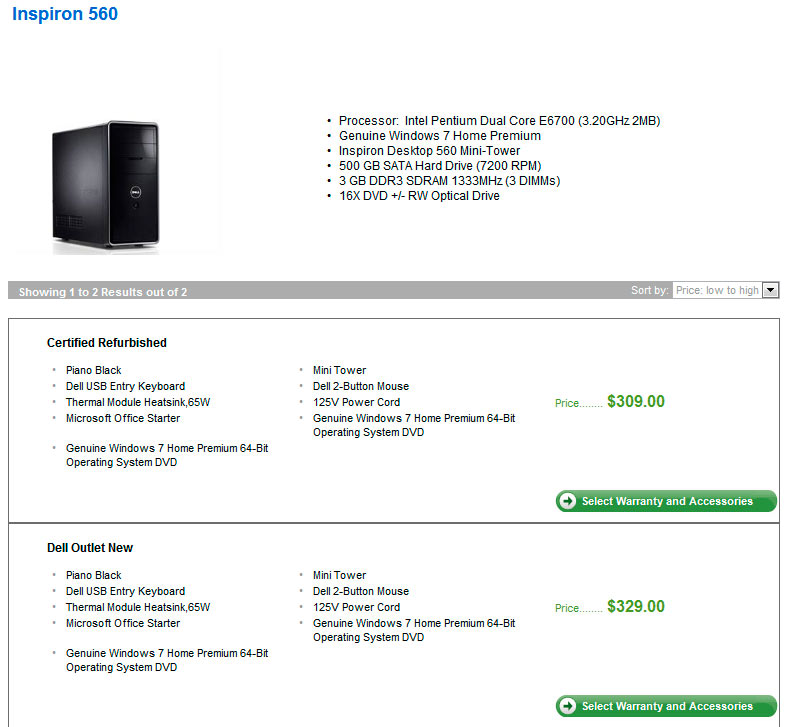

SightLine
Video card is not really going to help much of anything other than gaming. Depending on your operating system (I'm going to venture to guess it's 32bit) you could max out the ram which will probably be 4GB (with about 3.25gb actually usueable by Windows - not going to try to explain this lol). The motherboard can probably take a faster processor. That and the ram is about all you have - might be able to go higher on ram if you want to upgrade Windows to a 64 bit version.
You will probably have to find a used processor on eBay to upgrade that - ram shoudl be easily available. Being 5 years old - it's pretty much outdated. The third thing that might add some speed woudl be a more modern and faster hard drive but then again you will probably hit controller limitations on the motherboard. I hate to say it but it's a waste of time in my opinion. Anything you do to upgrade it is not going to make much of a noticable difference. Save your spare change for 2 months and add that to your current upgrade budget and you can buy a completley new machine that will blow it away in speed (even upgraded).
Edit to add a Dell... - it's nothing spectacular but for a hair over $300 the machine pictured would blow your current system away. Dell outlet often has halfway decent machines pretty reasonably priced. You would probably spend at least half as much upgrading the ram and processor and close to the same if you upgraded Windows as well on your current system. Probably even better deals and options if you look around some more and maybe other will give some too.
