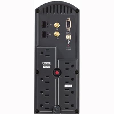

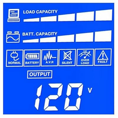

    Just wanting to contribute here by recommending what appears to be a great product.
    The model is CP1500AVRLCD. It's a 900 watt UPS.
    The 1614 idles at around 30 watts, runs at <100 watts, and peaks at 700 watts. (I'm talking about the "Mains" not the heater)
    I don't know what it's doing when it peaks at 700 watts. If anyone does, I'd love to know.
    This UPS is powering the Main side of the 1614, the take up reel, and the RIP station. It has a blue LCD display which gives a bunch of info but most importantly it gives load and battery life....AND it looks sexy. (compared to the clunky looking APC) Also, it is about 1/2 the size of the old APC 1400.
    I paid $180 with free shipping from an online store. It's very cheap insurance for a $20K machine. I highly recommend it.
