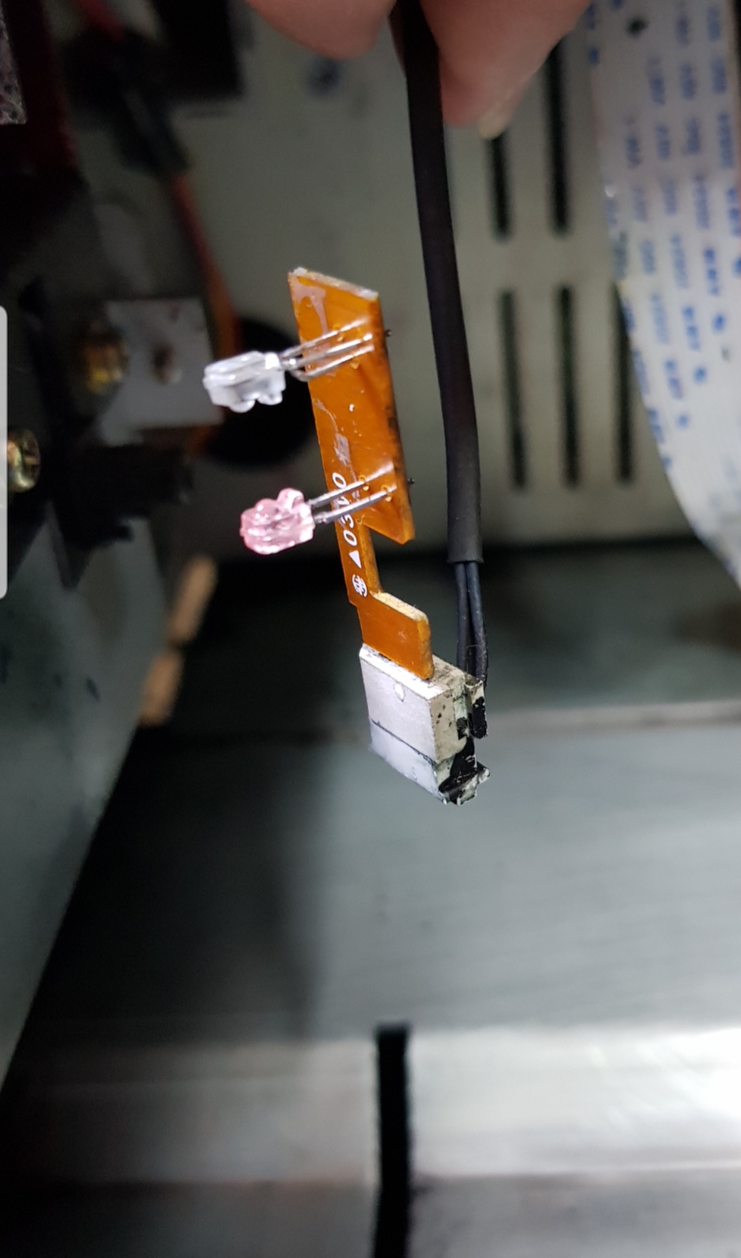

Hi
What this sensor and where is install?
damonCA21

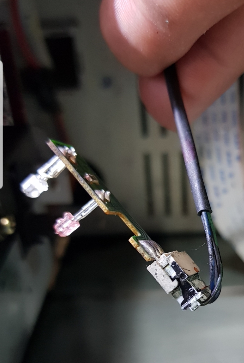

It is an encoder sensor, but there should be a black cover over diodes so it won't work like that. Can you post a pic of the front of the board and I should be able to work out which one it is as the printer has various ones in different places
FALCON
The cover is broken
This sensor is behind the cleaning section
FALCON
Yes, it is the wiper position sensor, it tells the printer when the wipers have moved and gone back into the correct position. If this is faulty the printer wont initialise properly. I have the sensors in stock if you need one
