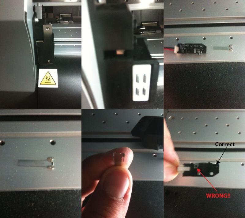

DRS05- I had the same problem this morning. All tabs were in place, but I still couldn't get the message to go away. When cleaning the printer, I remember bumping the tab on the left side of the cover magnet. In doing so, I knocked off a piece of the switch assembly. If you check both sensors on the cover, I'm sure you'll see that a silver metal tag inside the switch is missing on one side. You'll have to remove the sensor assembly, locate the metal piece that fell off and clip it back on. There are two "ears" on either side of the metal piece. Gently bend the two pieces together just enough so that it won't easily fall off again. Additionally, there are two ways to attach this piece. Use the tabs that are the farthest away from the connecting wire (square white plastic clip). Otherwise, it won't work properly (You'll notice that my picture shows it attached the wrong way. I had to take the whole thing apart again once I figured this out). I've included a few photos. PM me if you want me to walk you through this over the phone. Hope this solves your problem!
