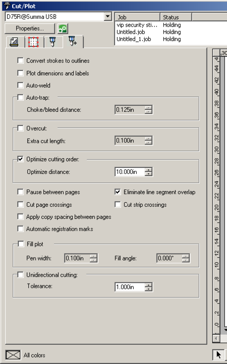

I know this is an old post but I solved this issue for you.
If using Flexisign you can check mark the box that says "Eliminate Line Segment Overlap" and it will cut those lines that overlap only once!
Thanks! I'll give that a try. Is your screen grab from winplot?
