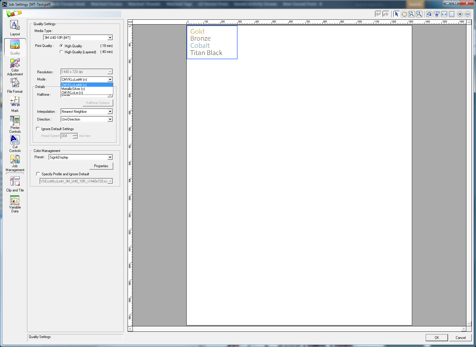

Here's a test file I just whipped up. How does it print at your end?
Dropbox - MT-Test.pdf
Just to be sure, you are using a print mode with metallic in the profile?
MetallicSilver will only output silver tones, no CMYK mixes.

Thanks mate, got it working but having lots of fun redoing all the colours as the old SP300 produces a different shade to the VS540I even when using the same cmyk values.
