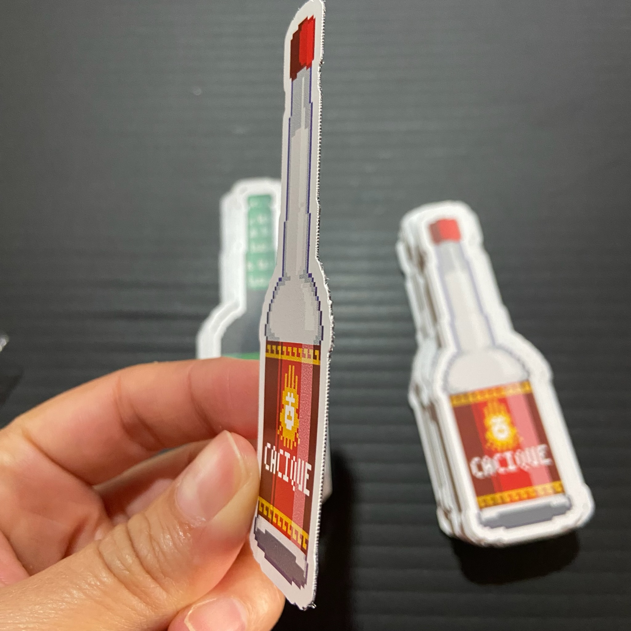

I print on my epson r5070 .15 and .30 just like vinyl. At 9 pass you get a little grainiest but at 14 pass look like cast vinyl
This are 9 pass , cut on a iecho pk
Just made 500 under 2 hours is a very profit material

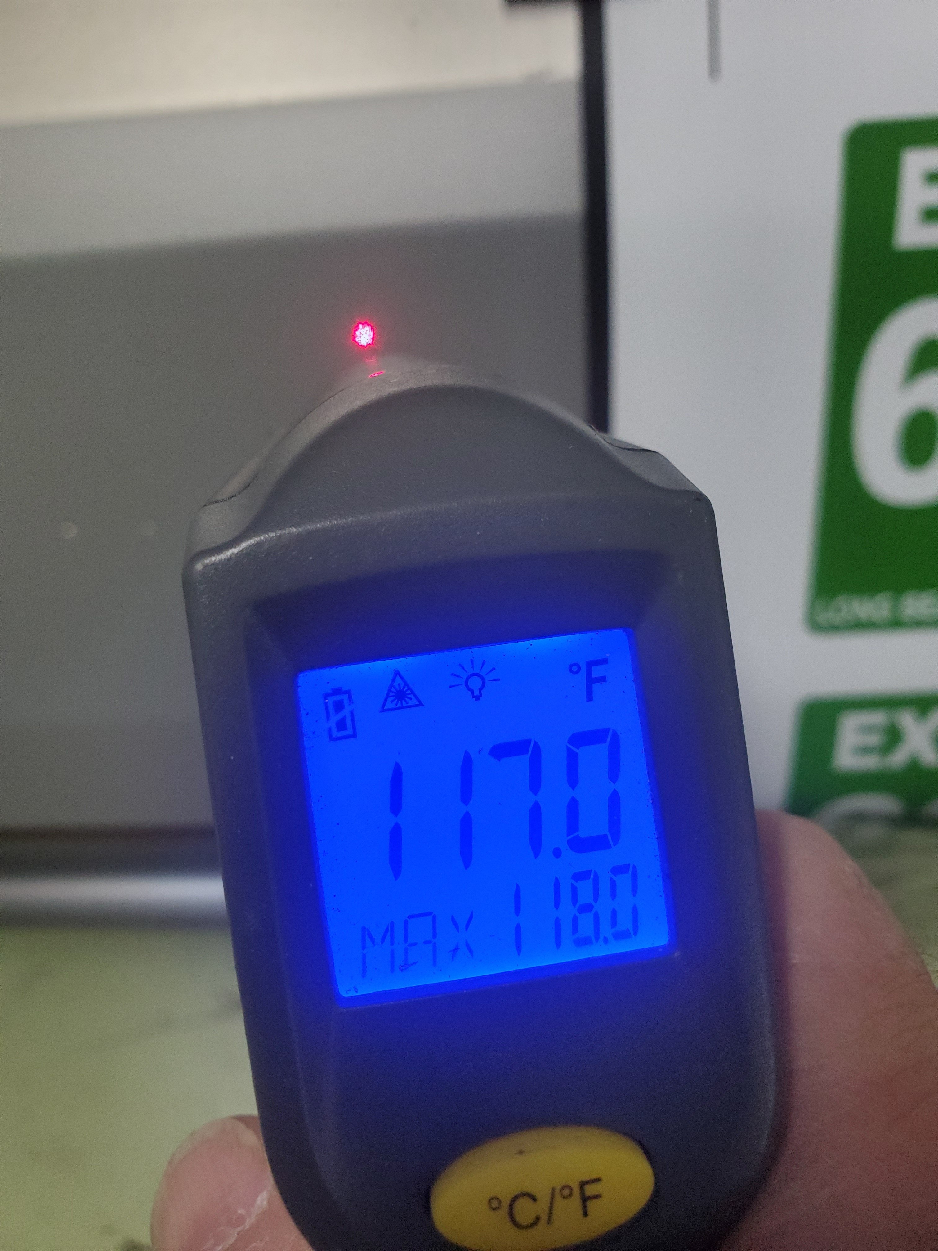

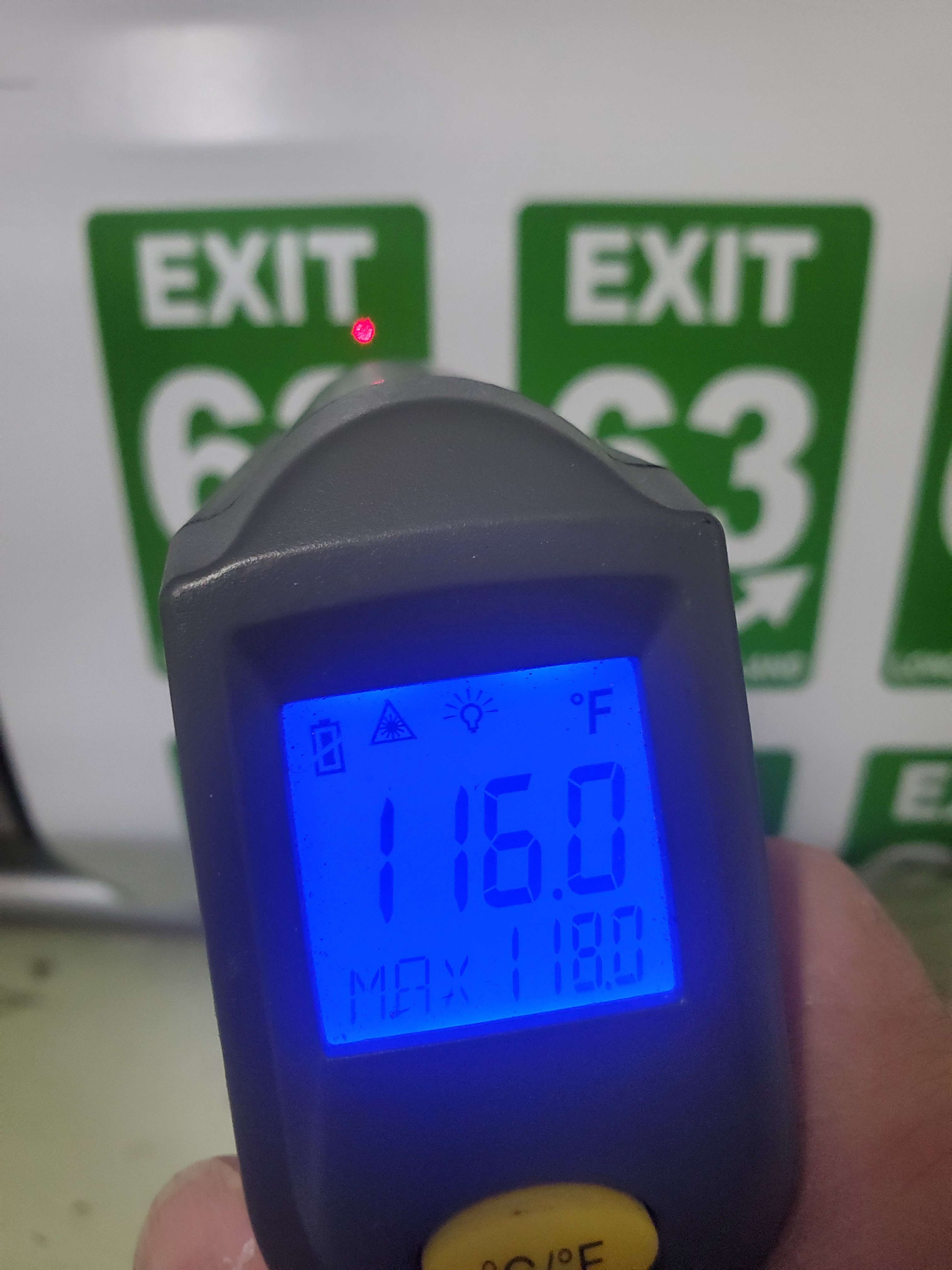

My Seiko Color Painter W-64 and Roland XR-640 heats up and penetrates .20 magnet material.
