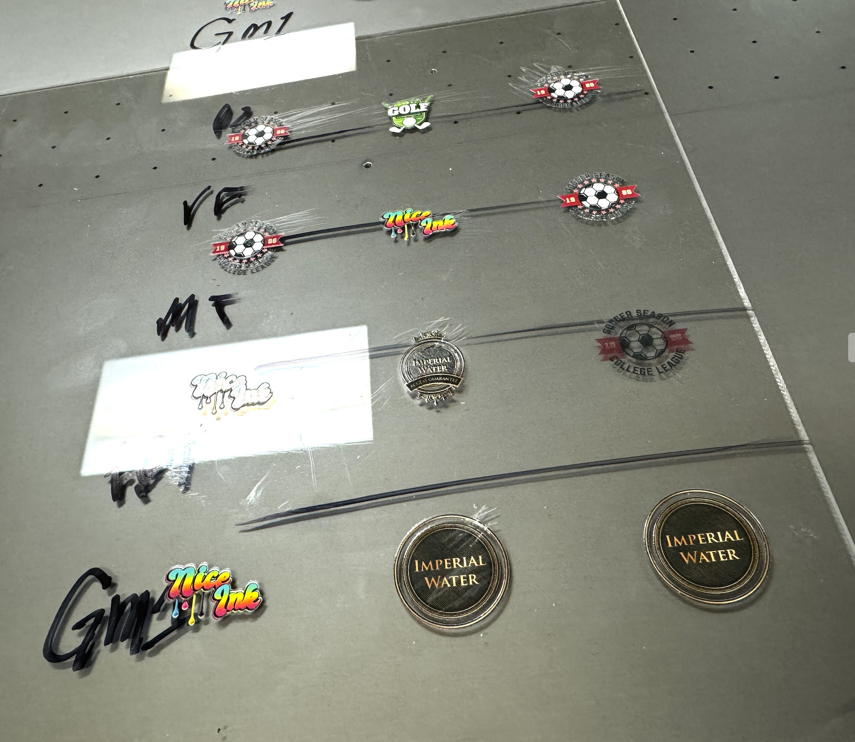

We have a new Mimaki JFX200-2513EX with LUS-150 inks (clear is LUS-100).
We're struggling to learn the process of properly using primer. We primarily print on acrylic, but sometimes on anodized aluminum.
For acrylic we selected the Mimaki GM-1 as a test chart at Mimaki during our demo found that caused no damage to the surface compared to others. It is apparently one of the few with no smell as well. This doesn't seem to achieve the level of adhesion I would expect.

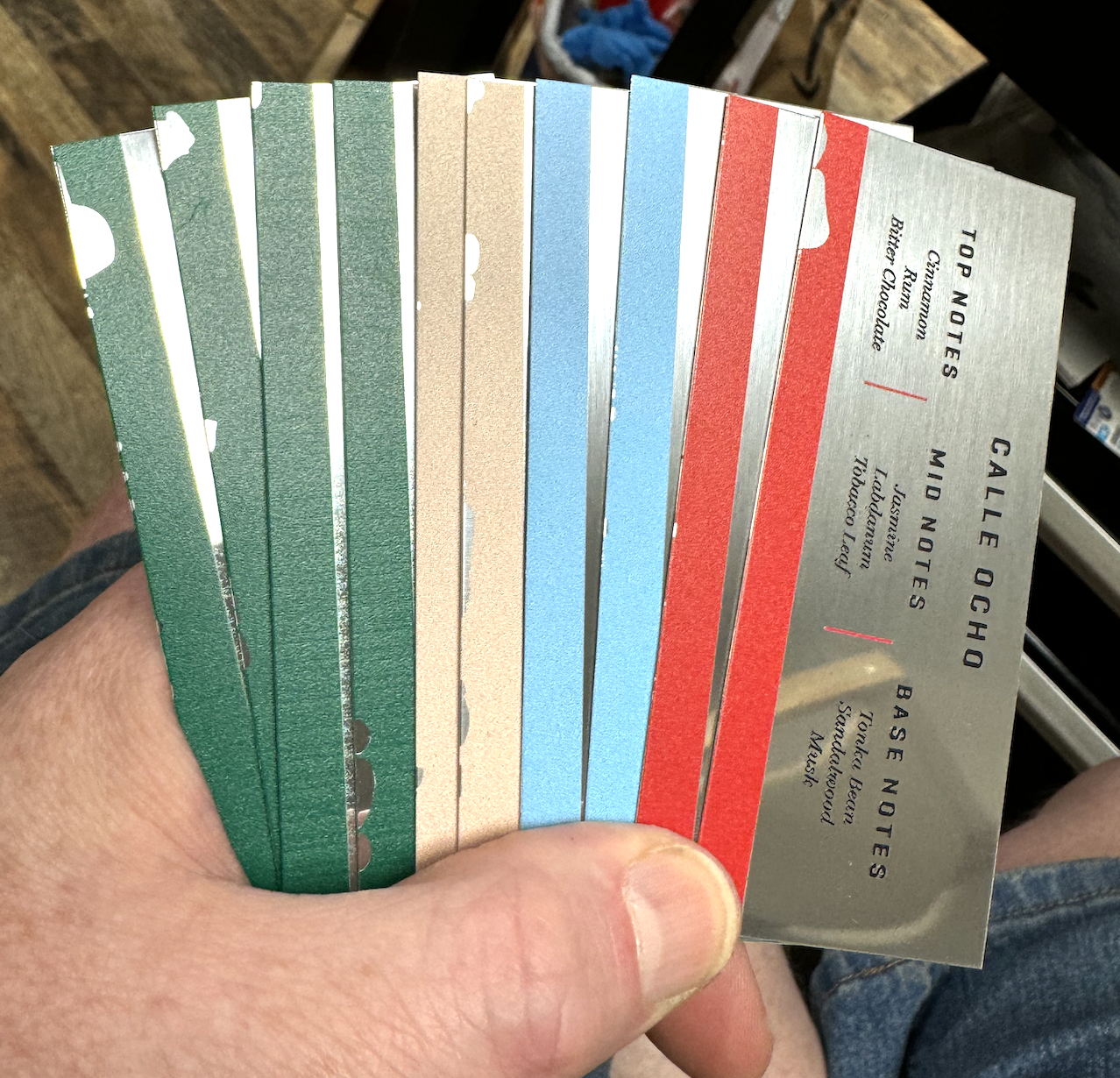

For the metal, we have been using one labeled VF from the ITNH primer sample set we got. It seemed to perform the best of the metal ones in the kit, but ink chipped when shearing the printed metal, so we changed to pre-cutting it. But then where the ink bled off the plate onto the jig, it pulled ink off just lifting the plates up. So we're clearly doing something wrong.

PR-200 is the primer it can print onto material. I didn't get that, preferring to have 2 white and 2 clear channels. I said GL-1 but it's apparently GM-1 that I have. It says it's for metal and glass, but the picture I posted is the acrylic test sample I saw at Mimaki and it seemed to work well.

We use P2 primer for metal (we get from ITNH) and works great. When shearing after print, if it is full bleed, you will always get chipping, even if baked and cured for 24 hours. Never had a problem with this doing full bleed and pulling the ink off. Basically put the primer on a lint free cloth, apply and let evaporate. Never had to pre clean the metal either, but use isopropyl alcohol as others have mentioned. Also there should be no shame in telling customers you need a metal border to avoid chipping.
